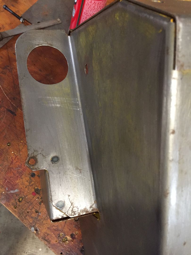

Nice as always Adam. It looks like you're using a chemical stripper for some of those parts? Tail strip?
Thanks. I'm not sure what brand the stripper is but is works much quicker than sanding and scraping.

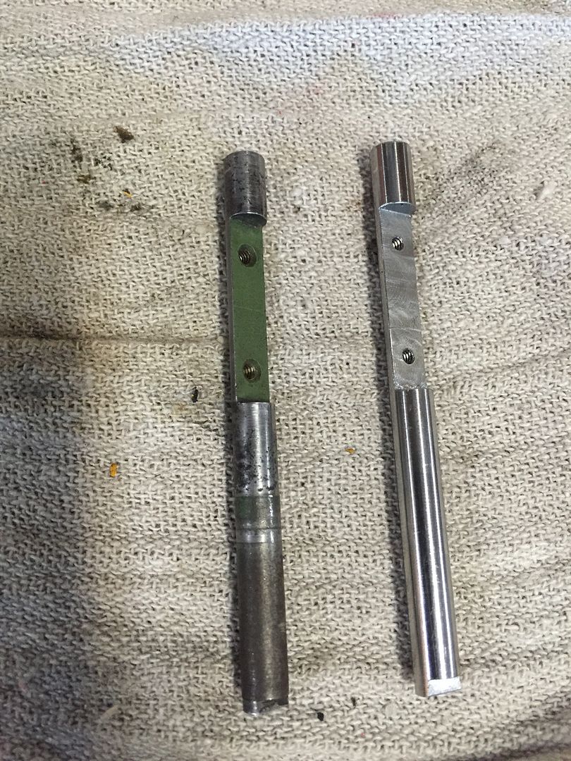

Made a new throttle shaft today to replace the worn shaft.

Very nice. You guys and all those "special" machines you have access, an knowledge to build parts, lucky son's of guns... (very jealous )

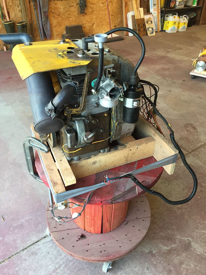

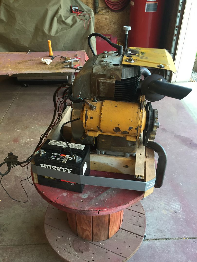

The engine lives again! I did have a dumb@$$ attack and tried starting it with the +coil wire hooked to the negative post on the battery. A coil doesn't work too well with no power going to it. Doh! Once I realized my wiring oops, it fired right up. Now, I can clean it up and shoot some primer on it.
Started working on the hood. I had planned on trying to find a better hood but decided to go ahead and fix mine since the chances are pretty slim of finding a 50 yr old hood that doesn't need work.

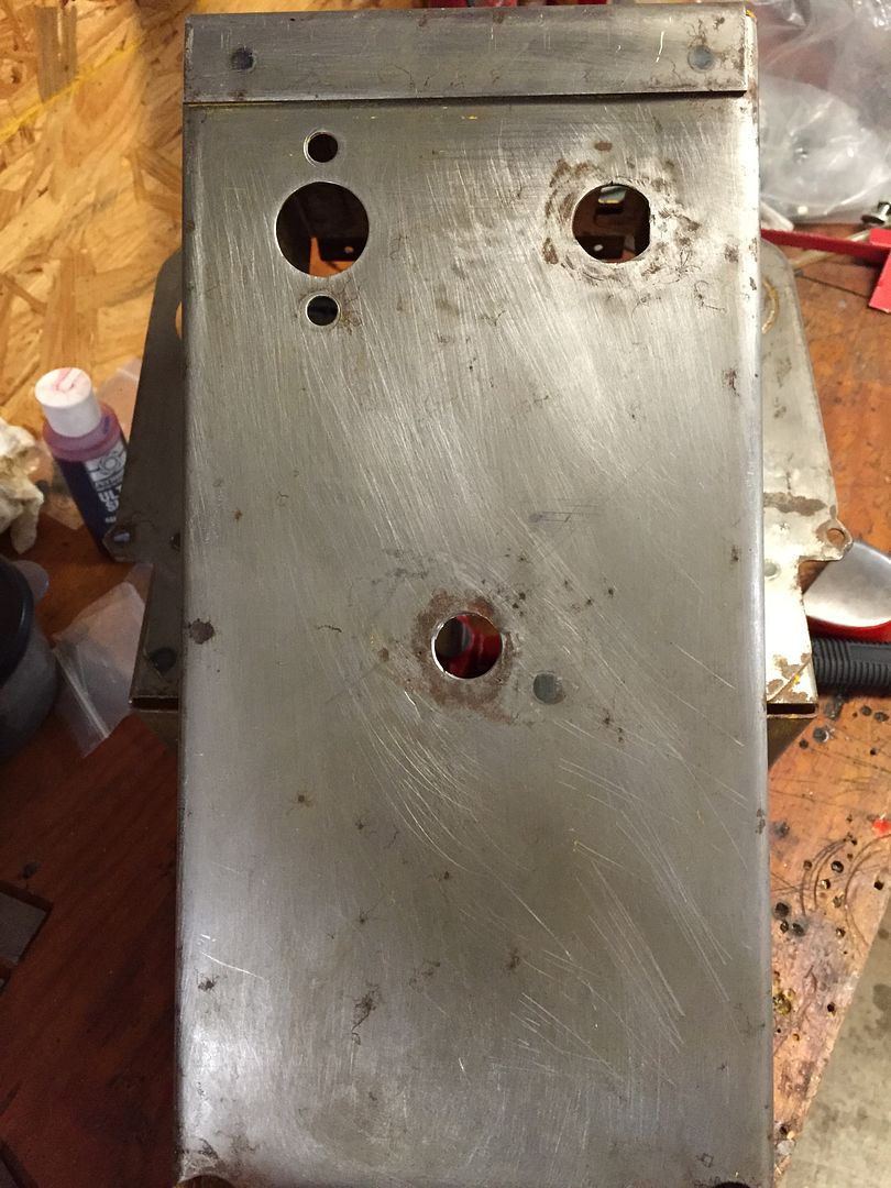

I'm almost certain I'm gonna use CaseIH paint. I've not heard any negative comments about it from anyone here who's used it. May stop by the PPG dealer and price a lower end auto single stage paint too.
Today, I worked on the tower a little with a hammer and dolly to straighten a couple spots. Made a few patches to fill some extra holes too.
Ammeter gauge hole. My bad.
Switch hole and start of hole sawed spot. PO mod.
Mystery hole below key switch. PO mod.
