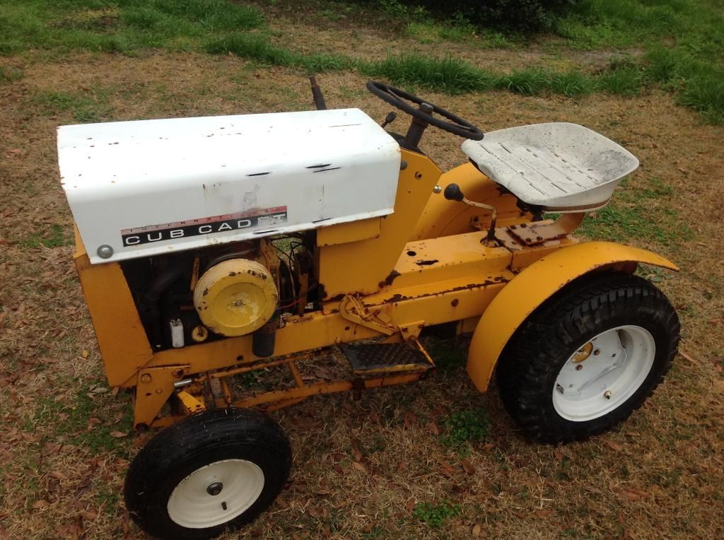

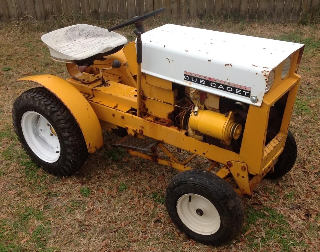

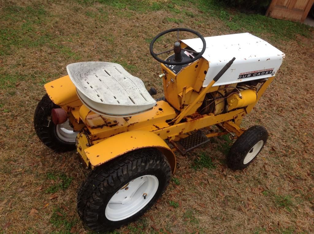

Got a little work done to the 70. I fabbed up a mount for the smaller 7-hp tank and spent a little time cleaning out the carb. I checked out the diff (only had to remove two bolts) and everything looked good. Sealed it and filled it.
Figured out some of the "extra wiring" that hung on the front of the engine and shortened a few as necessary. A couple more terminals, some new battery cables and a hold-down to keep it from floating forward and it was ready to run without hot-wring everything. New starter button and a new key made it stop and start on command.
I cleaned it up so that I wouldn't need a doctor's confirmation that my tetanus booster was up to date each time I sat on it, and I must say, the ol' girl isn't looking too bad! Couple more things and it'll be slinging grass soon! My brother has a deck that I'm going to try and fit to it. It's not the cast-side type, but the grass won't be offended.
Here's some pix of the progress!
Hope ya like it!

Looks great buddy, nice progress, glad to see that auxillary gas tank has been removed. I texted you a couple times lately just to see how you've been. Hope things are going well.
PS: you might want to Flip that drag link tie rod end over or it will get bent with some articulation of the steer axle.

I'd like to locate the plate that attaches to the transaxle and acts as a solid platform for the seat to bolt upon. As you can see, I have the small one, but need the larger one. I can get one made, if I can't find one. The reason is that I wanted to lower the seat, and I figured that bolting it to the diff would lower it, and I don't think that it'll hit the fenders. Once I get a plate, I'll try it and see.
My Originals both have the plate, but they're using them! Maybe I'll borrow one to make a template.
