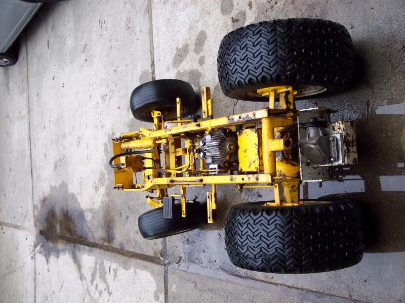

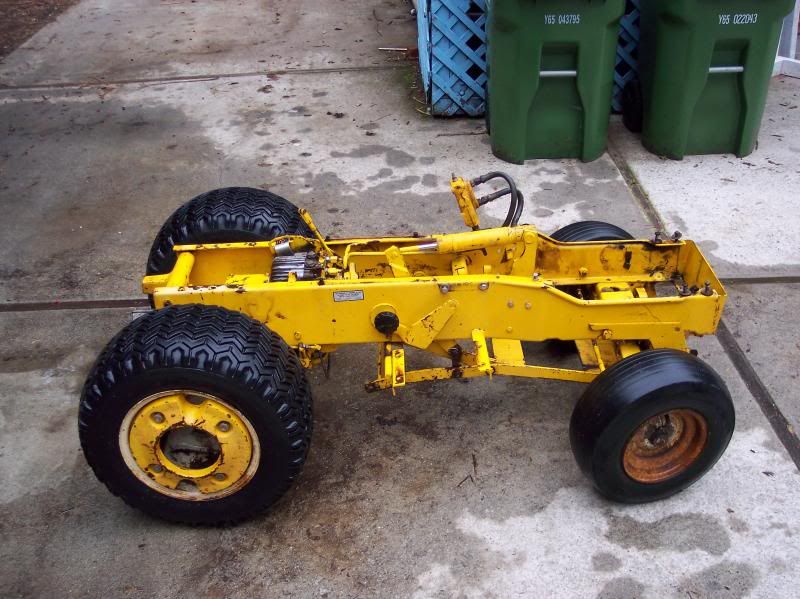

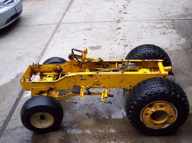

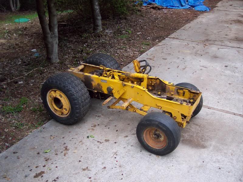

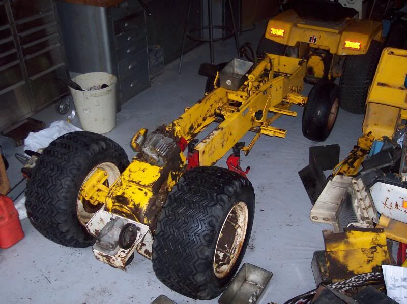

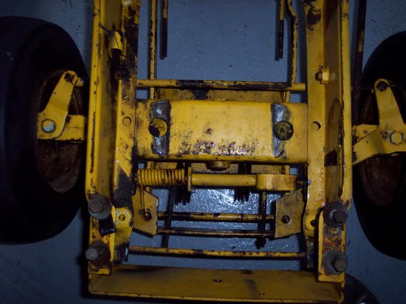

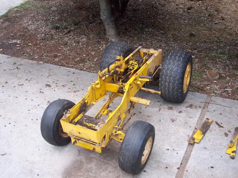

I got into the 1450 last weekend and this weekend. Here's what I did:
I stripped it down to a rolling chassis. Then I borrowed a pressure washer and cleaned off the crud. After that I split the tractor so I can start replacing parts. Here's the photos:
Before:
After:
Split Tractor:
I've never split a tractor before. It wasn't that bad.

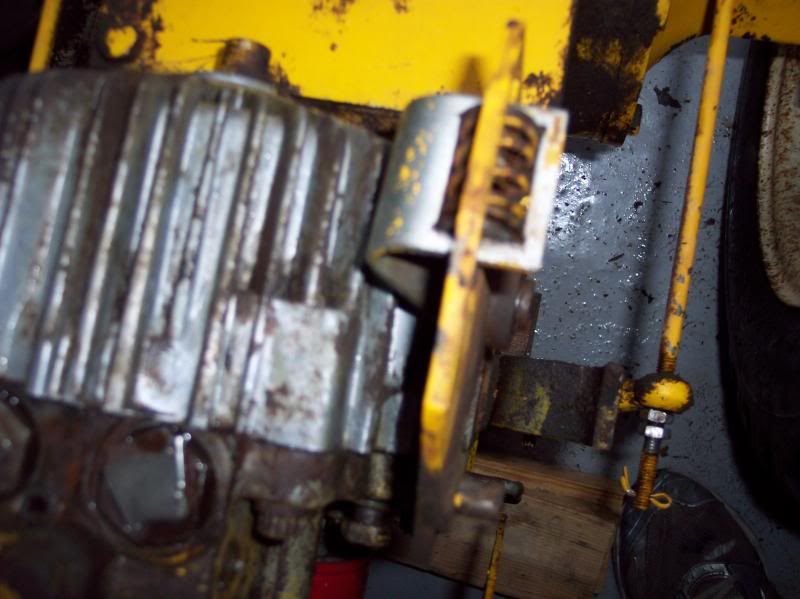

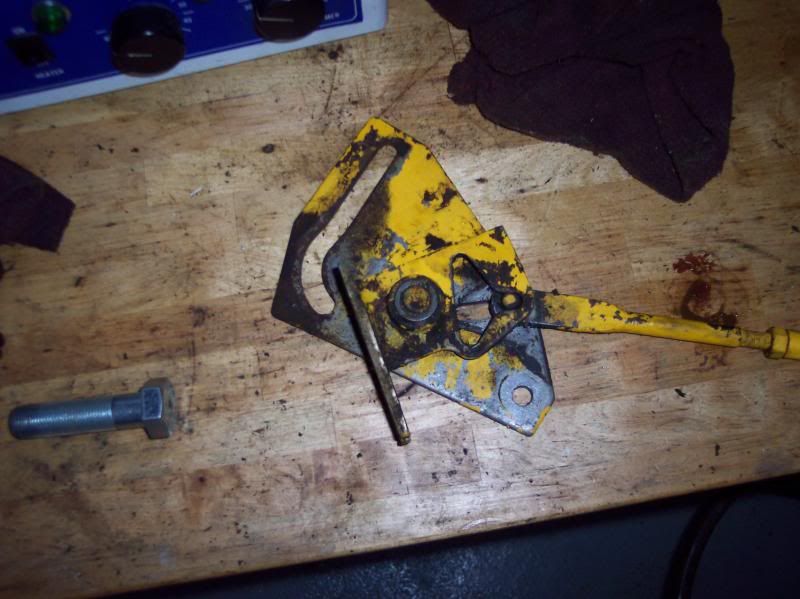

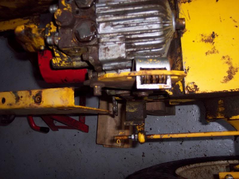

Looks like I need to fix that trunion:
The sector shaft that the trunion is attached to has play side to side. Parts tree shows there is supposed to be a washer behind the trunion bracket. Can I remove the sector shaft without disassembling the pump to get it back in?
There is a washer missing in this joint that is causing side-to-side play.

Do you think the ISOs were shot?
Any help with this tractor is appreciated. This is my first hydro and I want to put it back together right. Here's a couple of questons:
1. Is sector shaft side-to-side play acceptable?
2. Can I remove the sector shaft and put it back in without disassembling the pump? Will the swash plate fall if I remove it?
3. Is play between the cam plate and truinon plate acceptable?
Thanks in advance,
Bob

Bob,
Wow you have taken on a large project. A this point it seems like a lot of items.
I can comment on the trunnion, Yes it will work better if repaired. If you take it apart the corners can be welded and filed smooth to remove the grooves caused by the springs. There is also a quick fix too that just adds two new steel strips ove the grooves.
Looking at your list reminds me of the 147R I did You might look at that post to give you an idea of the road ahead. Yes lots of parts. And I did have to buy a donor tractor to get some things. But I think your tractor is in better condition than the one I drug home.
By the wat some of the early pictures still don't show up but the last ones look fine.
