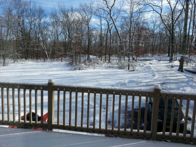

it was about 5 inches of fairly fluffy stuff but there was a side of the driveway I was stabbing at closer to 10" built from a previous snowfall last week. I eventually bailed on that side as there was more snow to clear.
ugh, just realized the most previous snow fall two days ago, not last weeks! this is getting old quick!
this was from last weeks snowfall:
Wish my drive was that flat when I lived in CT. This was the winter that did it for me and what I used to plow. Date was 1/12/11
