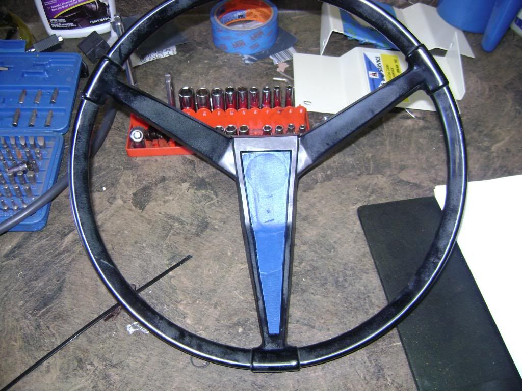

I would get a small piece of aluminum flashing at the local hardware store. Some of it is thin enough to cut with some heavy scissors, make a template, and then cut it out and fit it in there. If it has some crinkles in it, place it on a piece of ceramic or hard floor tile and roll it carefully with a smooth rolling pin.
Oughta work.
Dave

Here is how I decided to make my template. Will pull the tape and apply it to the metal and mark it. Best part of this is you are able to get the screw hole exactly where it needs to go.

Looks like a couple good ideas from Dave and Dwayne. Looks like the way to go for finishing up the steering wheel. Thanks Guys.
