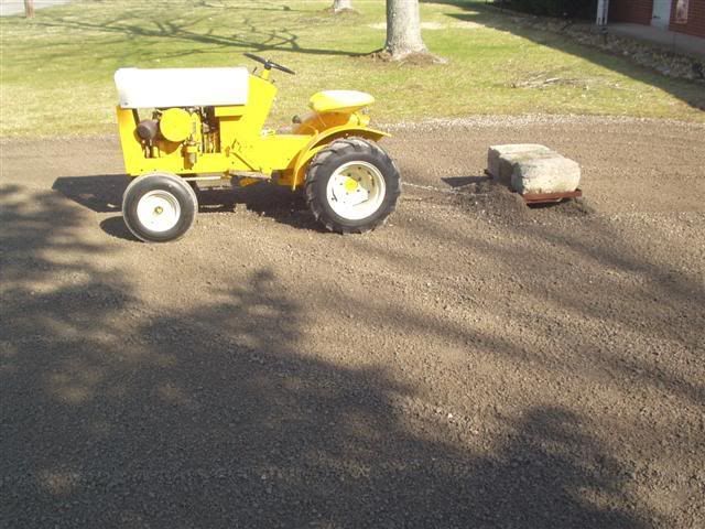

This what I use on my drive way
Behind my 100
Closer view
Finish drive
