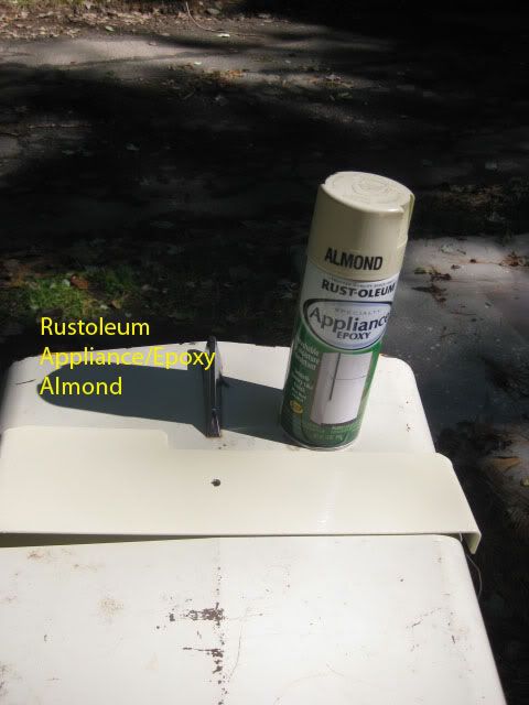

So is the pto normally painted cub white? I might just paint it before I put it on. Might as well while it is off. Does TSC carry the cub rattle can paint?

They are usually painted white yes.
They have International White but this is probably a closer color to match your aging white.
