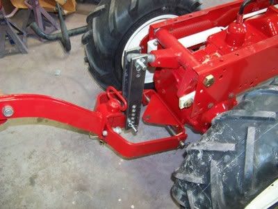

The slotted end bars are for floating capability and bars with a single hole apply down pressure. I would go with the slots.

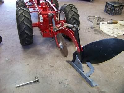

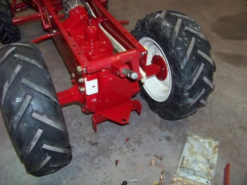

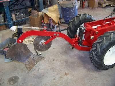

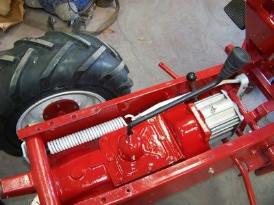

I got the spring lift assist installed. made and test fitted the lift bars. put the 10" plow on it , so to adjust the spring.
Doug
Original , 100 , 125 , 582

Doug everything looks great! For a moldboard plow you'll want to put slots into your lifting straps.

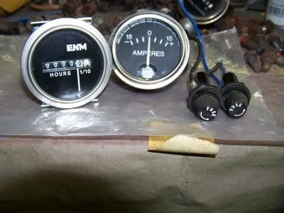

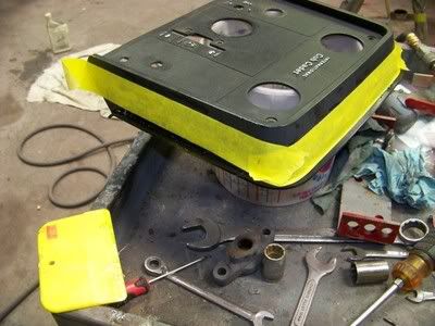

got some new dash parts , and started work on restoring the dash.
found the fuse parts in a computer control panel. they are better duty then the ones I took out.

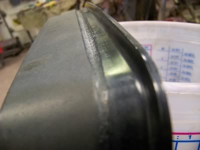

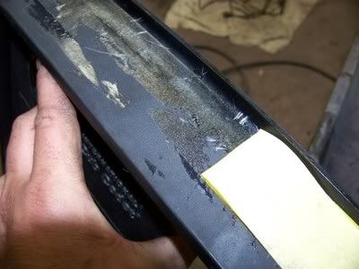

the the hood was cutting the dash a little , so I filled it with fiber glass.
ones I put the resin and glass mat on it , I put painters tape over it to rub out any air thats under the resin. let it set up and pull the tape off (slowly)
tomorrow I'll sand it , fill any pin holes with glass filler and prime and paint it.
