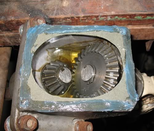

my other problem is my gear box gasket. i serviced the gearbox with new gearlube and used some old gasket paper for a gasket. im thinking it might of just been too old so thats why it leaks. so question is, what kind/type of gasket paper do you guys use to make your gaskets? would also like to use the same paper for rear end gaskets too. and do you use sylicone on the gear box gaskets? thanks for your help guys

Your gasket might have been too thin...the original is cork and is at least 1/16" thick IIRC.

I just redid a cast iron rear end and I used neoprene gasket material with RTV - no leaks for me, I am RTV happy though.

I cut my own gasket too, but put a layer of silicone gasket sealer on each side..seems to be working fine

blue loctite works great like mattg said. you can buy sheets of cork at yur auto store and cut it to fit. you can if you want also rub a thin layer of gasket maker on both sides. you should also replace the outer bearing on the pulley shaft. mine turned fine but when i pulled it all apart it was shot. the seal was rotten and the bearing was close to fallen apart.
