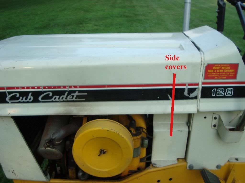

Are there any side panels that fit a 149?

Yep but they are kinda small:

That's them eh? I was thinking like 1650 style or the like. I keep having these ideas about minor cosmetic modifications. As it turns out, I have to invest in another whole tractor to get the look or option I want.

I would think that QL shields would work but you would have to modify the left side because of the PTO lever. The other side should fit if you have hydraulic lift. But you would have to drill a hole through (or weld to) the steering column for a bolt to hold the back on. No promises though, just my thoughts.

I think you'll cook the engine. All the Q-line and up have boxes around the muffler system and proper ducting around the heads for the airflow needed.

I agree with Oak, I think even if you cut louvers in the hood there's just too much heat contained around the motor...besides it's a good excuse to search out that next cub.

Good point on over heating! I guess if things were easy every one would do them. My new shed will just need to be bigger, the first one was 2/3 the size of my house!!! Good thing I'm single again.
