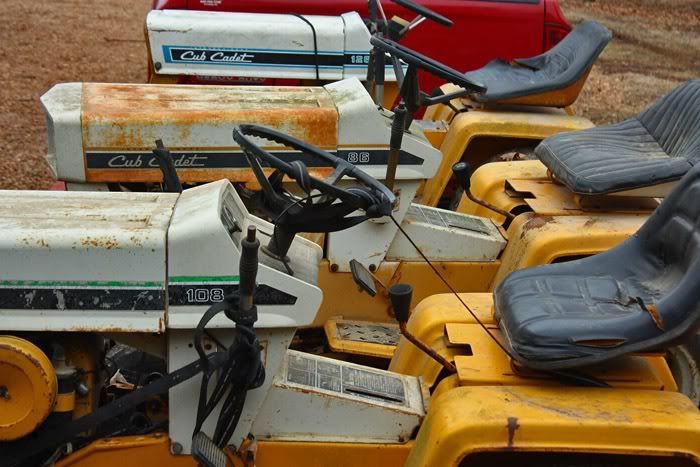

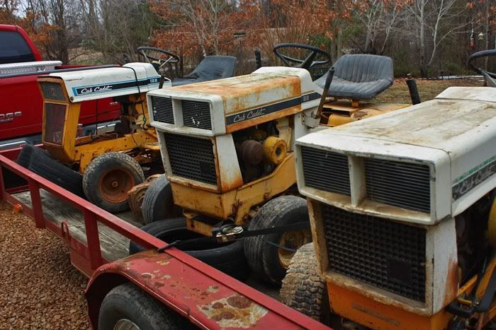

Thanks for the great site!! Picked up my first IH Cub Cadets on Feb. 7, 2011. A 126, an 86 and a 108, all have decks. The 108 and 86 both run...the 86 was running great after a good carb cleaning, tune-up, and clutch rebuild....until the exhaust lifter stuck
The 108 runs great!... it is just worn out..the K241 has already been bored to .020" over and the cylinder is worn to 3.285" (that's over .030").
The 126 is in pieces...it is almost complete..just missing some nuts and bolts and small little tid bits.

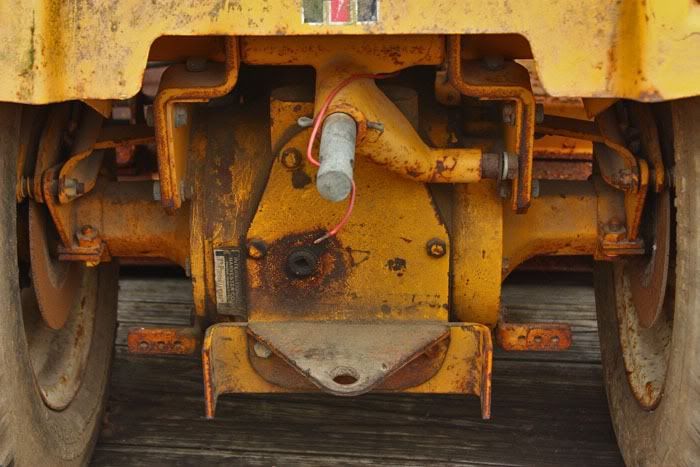

The rear of the 126

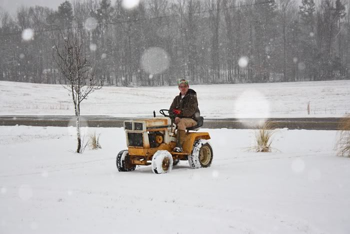

My son on the 86 in the Feb. 9, 2011 snow...

Wow, you jumped right in with both feet
Nice lookin' line up!
Take good care of the 86, they are actually rare, due to the low number built by IH.
The engine block of your 108 can be sleeved by a machine shop. Then you will be back to standard bore, and ready for many more years of service

Great looking set of cubs!! Glad you're on this site and already have the "yellow fever". Now, if you only had a blade on the front to push all of that snow with!!! That attachment will soon come....

GoatDriver: After looking at the picture of the rear of your 126, I noticed something.........the brackets on the left and right side of the rear end that have 3 small holes in each of them, are quite a commodity! They are a set of spring attachments for use with an IH rear blade/rake. Those brackets are like finding hens teeth!!!
