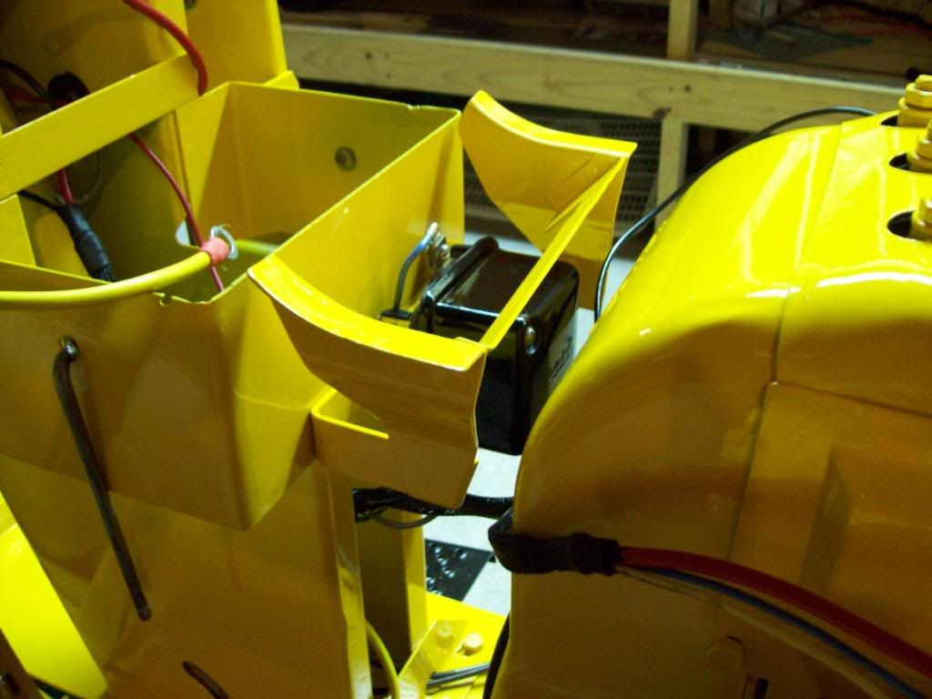

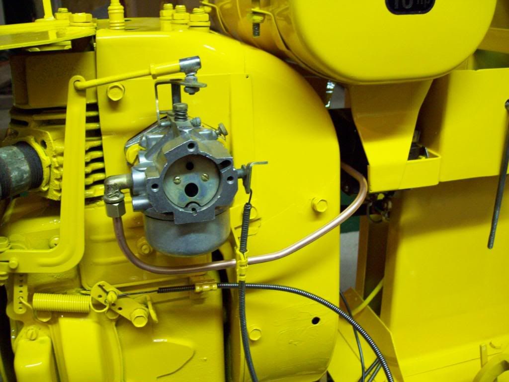

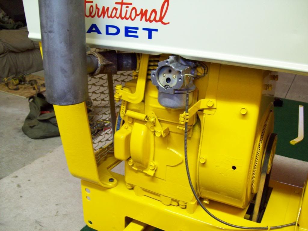

Yes, you will have to drill a hole for the drain plug and also either drill the thread out or take the welded on motor nuts that are on the uderside of the frame off.. I have one mounted in my CCO

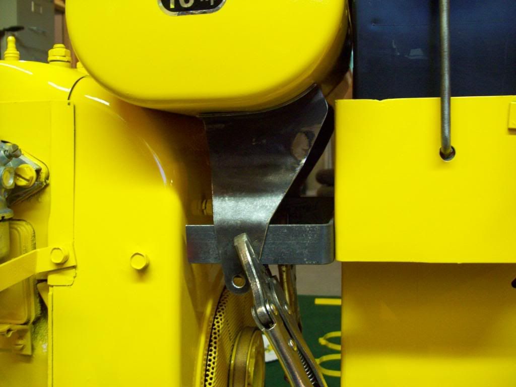

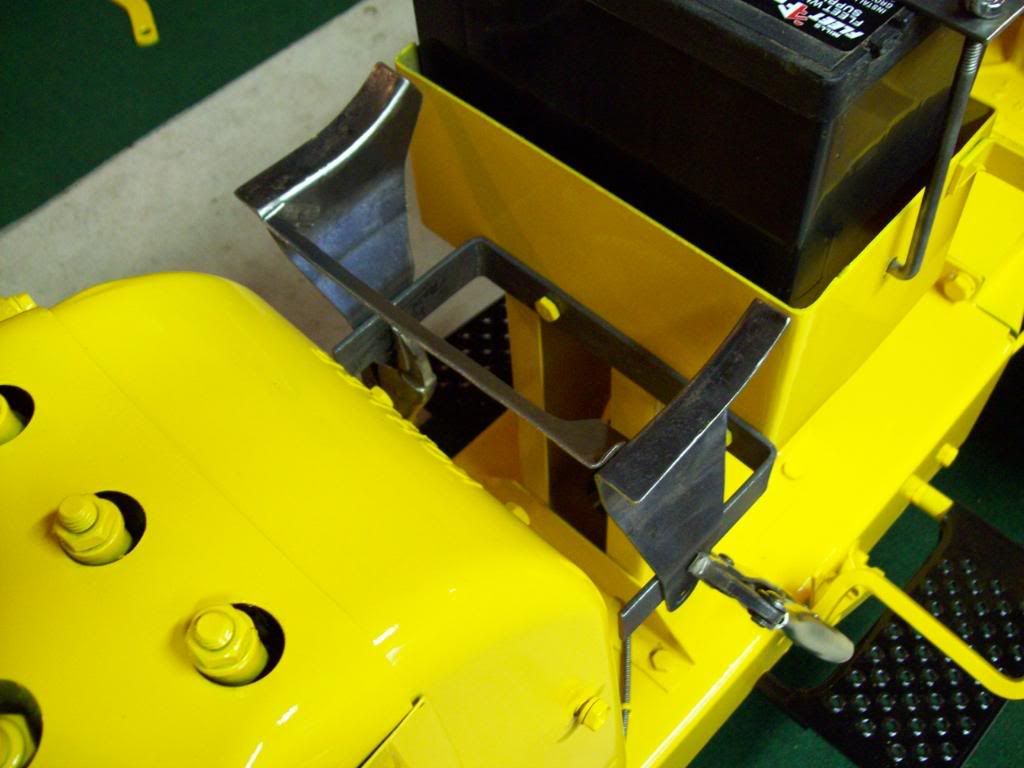

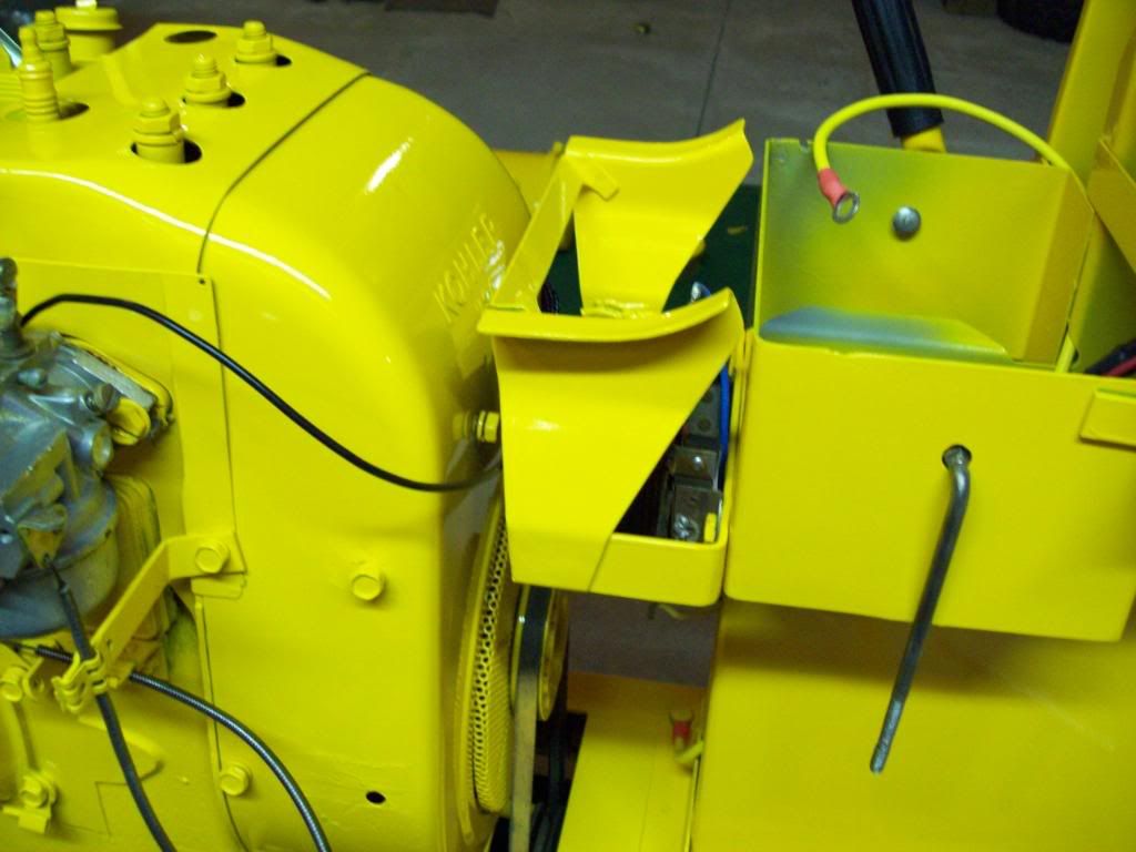

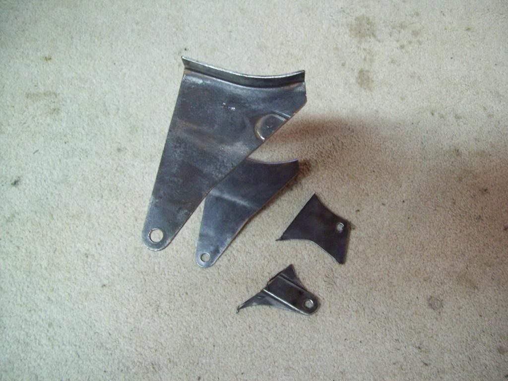

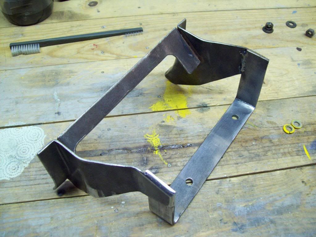

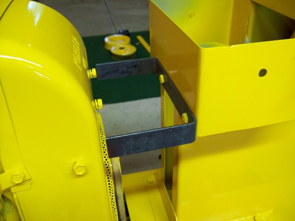

cadetfarmer, You're going to have to do that also. It is going to be VERY tight but it does work..
Basically I picked up another CCO tank mount and some strip stock. I tried to not modify any of the original parts so it would hold being complete as possible for the K161 when it is re-built. Here you go, this should give a pretty good idea. It uses the VR existing holes in the battery box. You will (should) either mod or fab up a new battery hold down strap also.
Sorry to load your thread up with pics, but they are the best answer I can give :biggrin2.gif:
