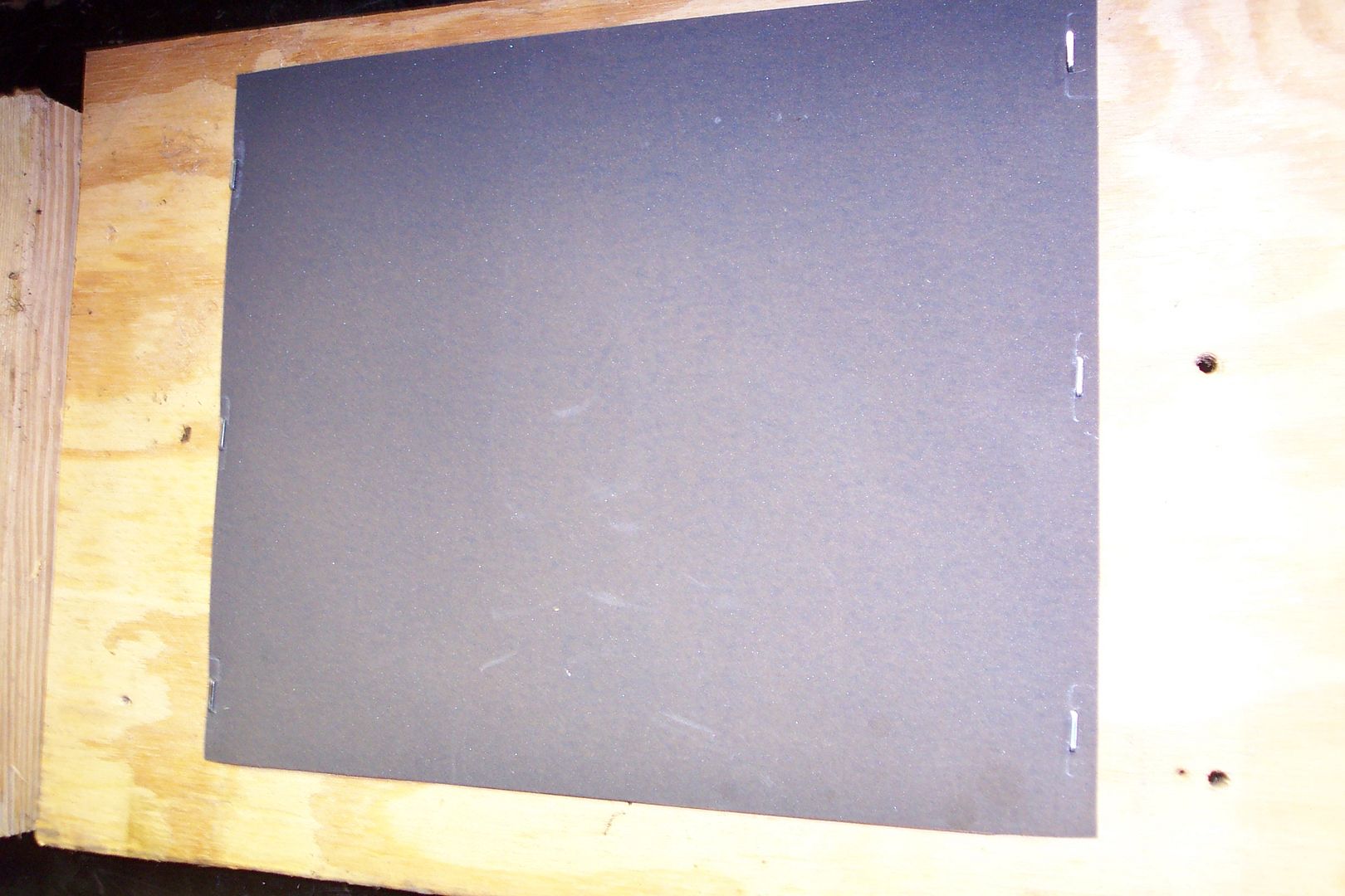

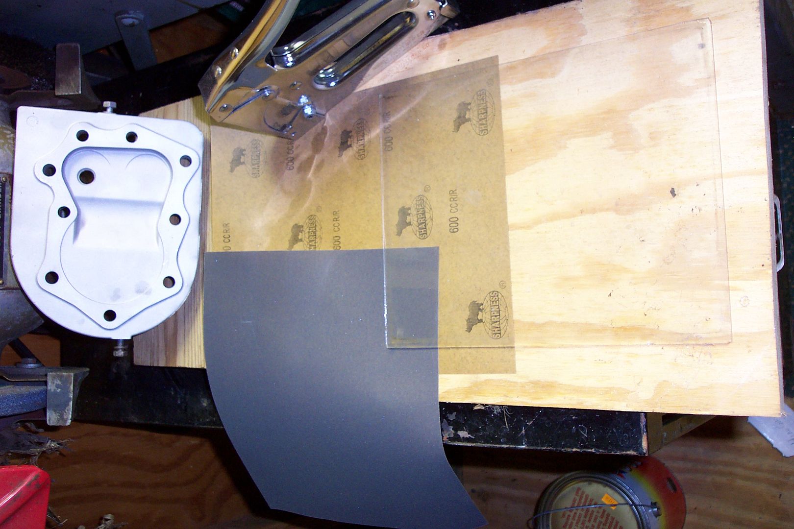

Sounds like what you did was correct.
I use 8-1/2 x 11 emery sheets ( sandpaper ) and as long as you keep it moving in small circles and turn in, it should be fine.
I had a piece of glass that the emery sheet just fit over. the glass was on a piece of plywood and I stapled it down.
