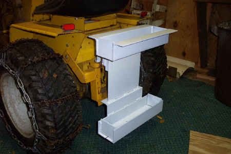

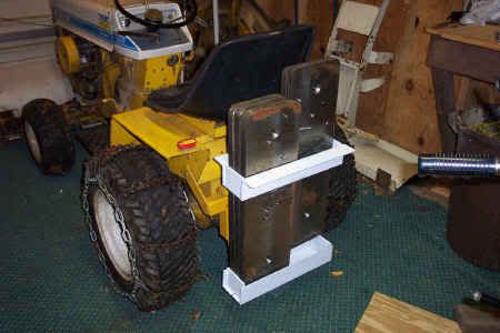

I made this bracket to go on the back of 125. It mounts to the bracket for the Trac Vac
I have steel plates to go in it
I really don't worry about chain marks ( click for large view)
I don't use the steel plates anymore as wheel weights are easier on wheel bearings. ( weights hanging on the back are better than none )
