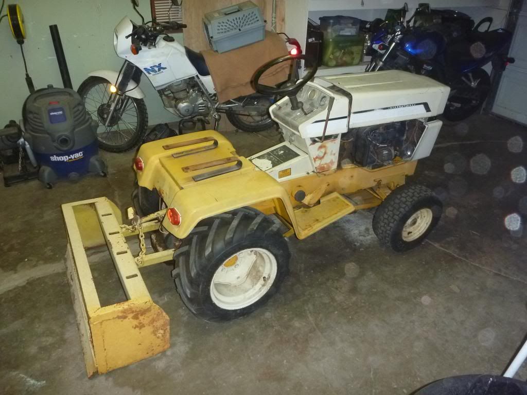

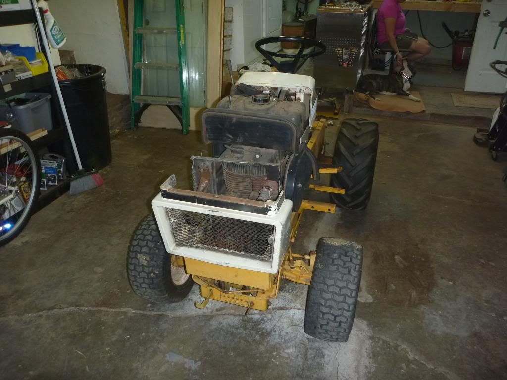

I see all of you guys threads on here and I've really been wanting to revamp one of my tractors. This isn't going to be a resto, just a refresher if you will. There will be some painting, but mostly I want a good working tractor that doesn't look to bad either.

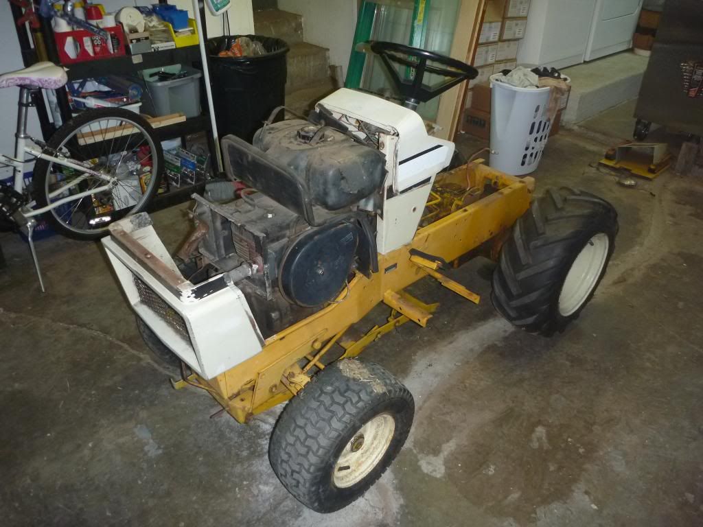

Here is what I'm starting with. Some of you may have seen this in my "Yellow fever has struck again" thread.

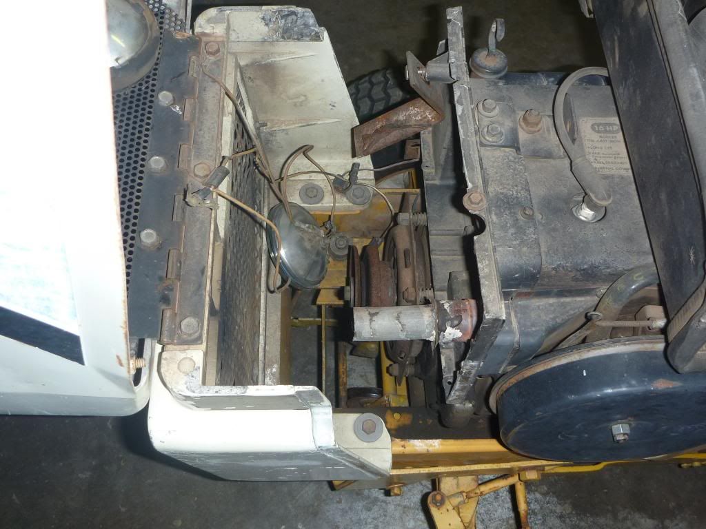

No muffler. I'm not too concerned about the tins around the muffler, but I will most definitely be getting a new muffler.
None of the lights work. One headlight is dangling by the wire. Terminal is broken on that light. All lights will be functional when finished.

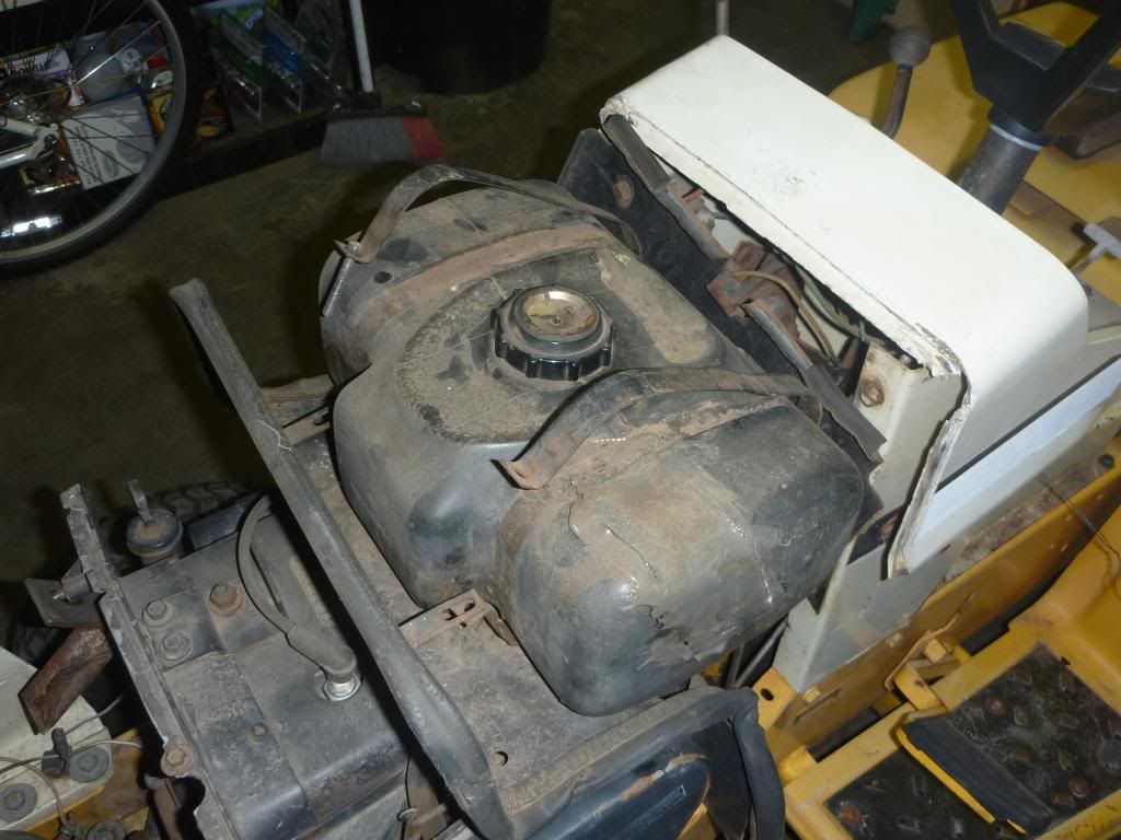

Gas tank is just sitting there. It looks like somebody was working on it, and never finished putting it back together......or they just used it as is.

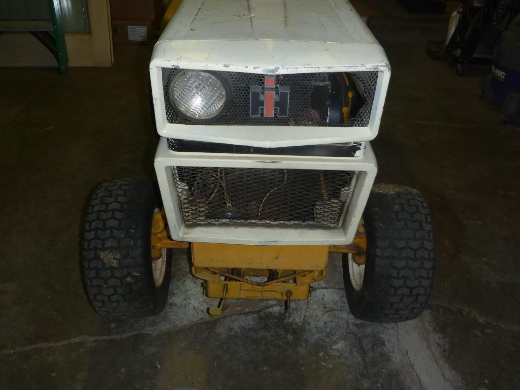

Just a shot of the front of it. My other 1650 has a circle cut out in the mesh grill for the exhaust to exit. This one does not. I thought all quietlines exhaust exited through the hole in the grill??

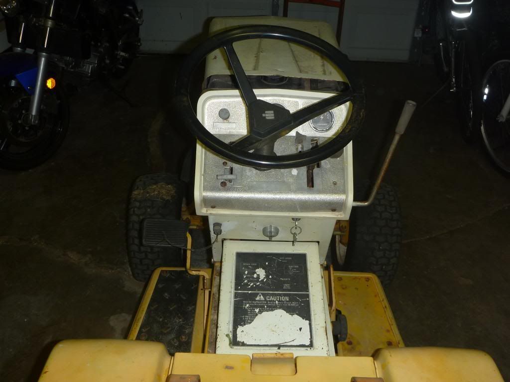

Steering is loose. Dash tin is completely faded out. Wires sticking out of the fuse holder.

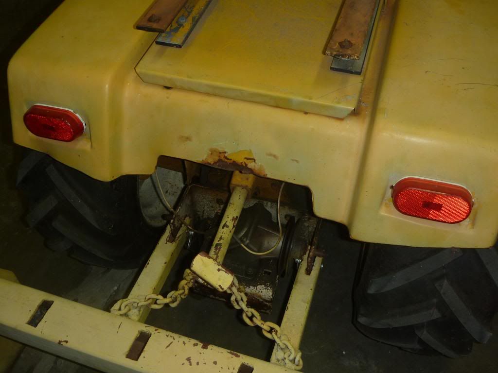

A little body work needed. There is also a small hole in the hood. Looks like maybe for a switch at one time. Have to weld that up too.

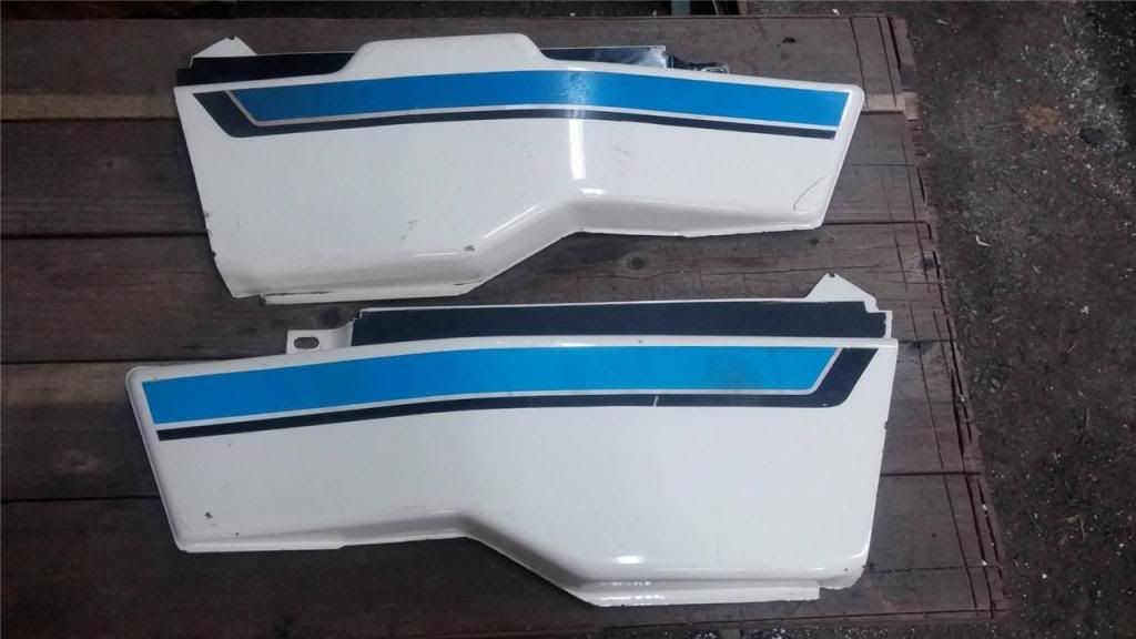

I'm not sure how involved it am going to get with this project. I'm just going to tear into and go from there. I want to fix all mechanical issues first. I just ordered some side panels off ebay that look WAY better than the tractor. So I will for sure be painting the hood, dash, and nose to look as good as the side panels. Then I'm going to HAVE TO order some new decals. Probably end up painting the frame and fender pan. We'll see.
Here are the new panels.

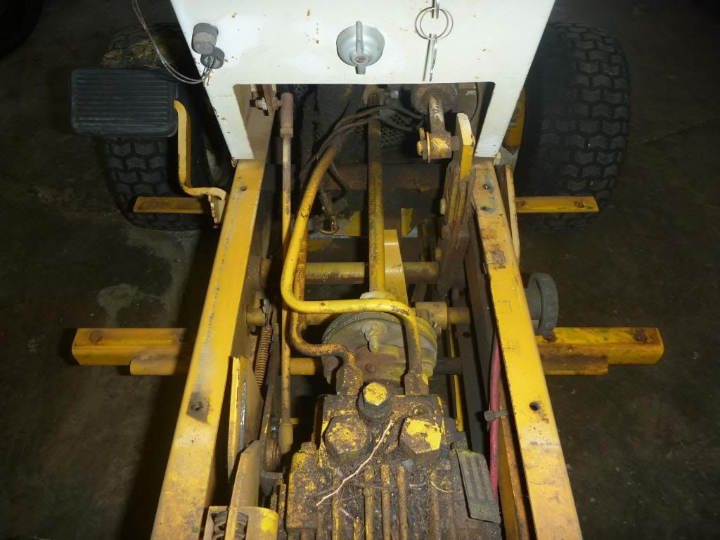

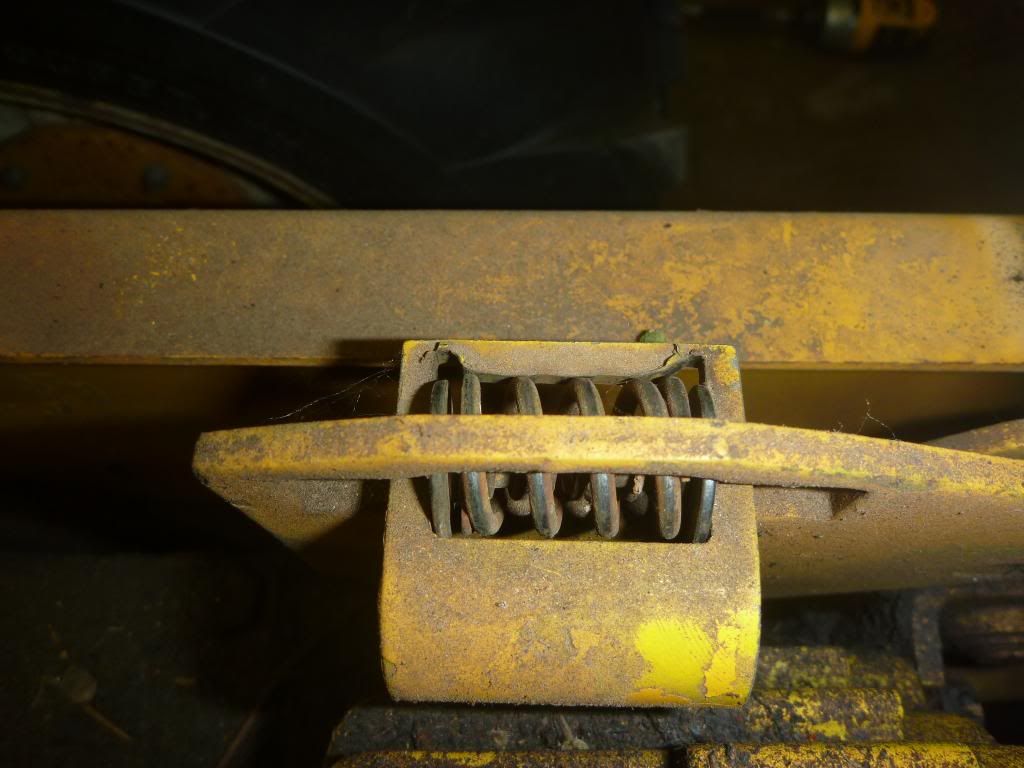

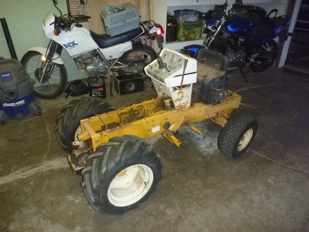

Well I started tearing it down tonight. Here's how it went.

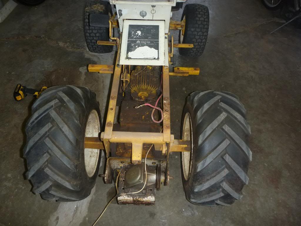

Fender pan off

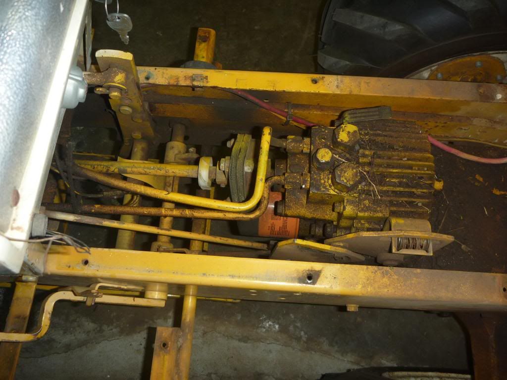

Trunnion

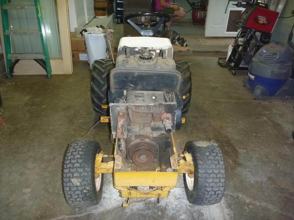

Who needs a fan!! Notice the fram filter.
More coming off.

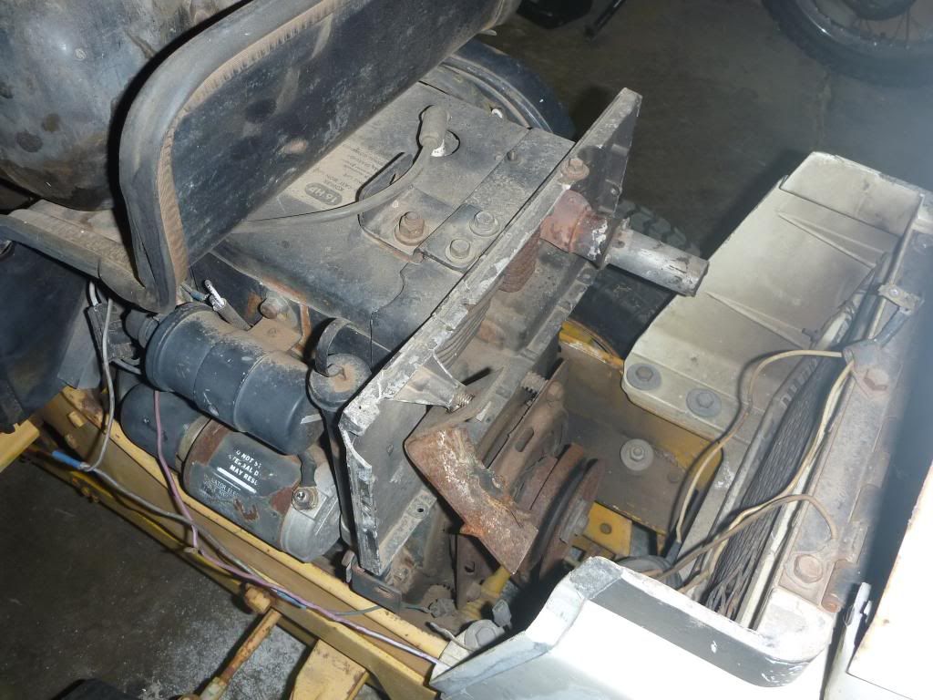

Literally the only things keeping the gas tank from falling off was the fuel line and the hood. Cool muffler eh??
Removed the piece that was behind the non existent muffler. It was broken.

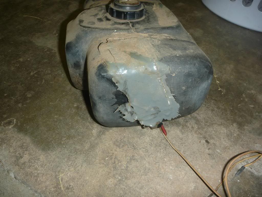

Going to get another gas tank. This is duct tape that is covered with what appears to be epoxy or sorts.

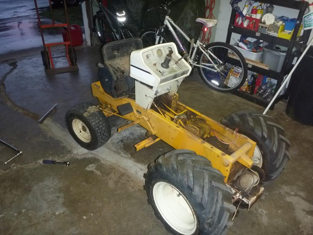

How it sits now.

Old 05-24-2014, 12:28 AM
Location: Fort Wayne, Indiana
Posts: 728
My 1650 doesn't have the grill hole either. I kinda like it better without it, personally.

Yup, that trunnion is roached.
Some of the QL's had a hole and others didn't, never really understood that.
