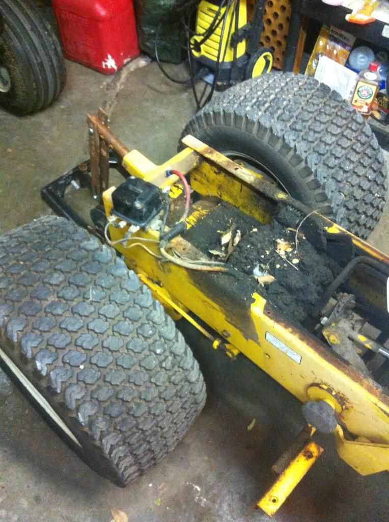

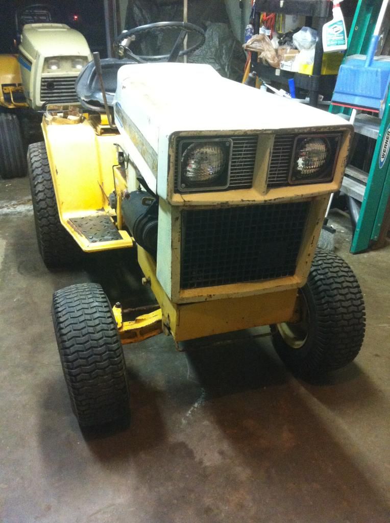

So I got this 149 around a year and a half ago. The hood and front cast piece had been replace from one off a 129 without the headlights. The wires were still intact, just had wire nuts on them. So, I bought a headlight panel from olds on here because.......well, I really wanted the headlights back.

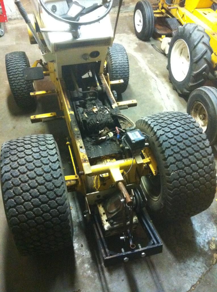

Since I've had this tractor it had a leak from the rear end. So I decided, why not fix it now???? Can hardly see the hydro or check valves. I'm assuming it's coming from the valves or the cork gasket. It leaks from the front of the rear end, but it's so dirty can't really tell. It does leak fairly heavily, so I'm thinking the gasket. I'll pressure wash it soon to try to narrow it down . Here's a few pics from tonight.

That looks like my 129-simply a huge blob of old fluid and dirt. I had to pressure wash mine again once removed from the tractor. Hard to tell where it might have leaked-so far I've replaced the axle seals and seals on the input shaft. Planning on the cork seal while it is out.

Wow, that's a leaker. Looks like your valves for starters. If you haven't washed it yet, I'd suggest newspaper underneath and a paint stick to knock it down some. Your wife might appreciate not blasting that against the side of the house!

I agree, valves are definitely leaking. Can they leak really bad? When I would drive it on pavement, there would be a drop about every 3 feet. So I would say that's a pretty bad leak.

I haven't washed it yet. Looks like it's dripping from the return line. I think that's what it is. Where the it goes into the rear end.
