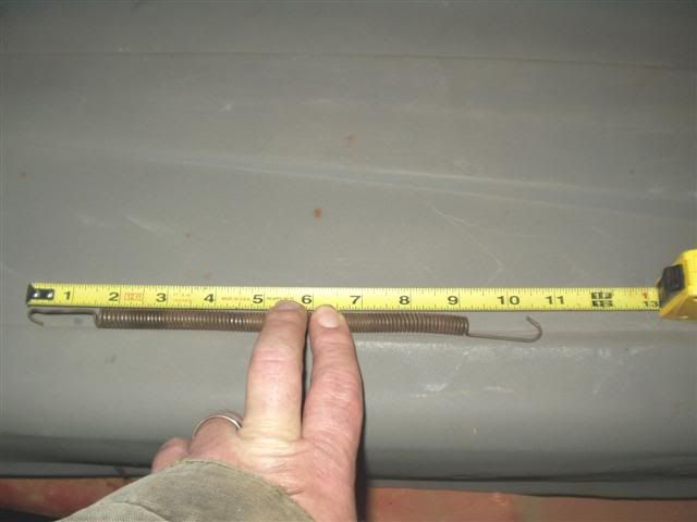

what air filter is for the k301aqs? right now i have my 104 air filter assembly on the 1200 with that side cover off.... which brings me to my next question. what are the tabs with holes for (in front near hood hinge ) on top of the side covers? is there supposed to be a rod to tie them together to keep them from rattling and making more noise than not having them at all? i dont use the factory exhaust, so wouldn't know if there would even be room for a rod across that area.
lowlyfzlucky 08-13-2010 07:48 PM
There is supposed to be a spring that runs across between the 2 engine covers. I got one at Ace that fit perfect. Only cost $2 also! :beerchug:
william1041200 08-13-2010 08:24 PM
sweet! that spring makes sense. its a pain trying to guess all the missing parts.
thanks
Merk 08-13-2010 09:28 PM
Here are a few pictures on the spring:

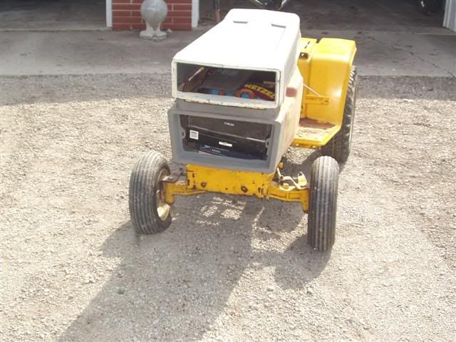

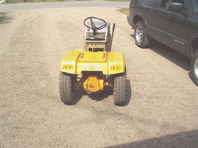

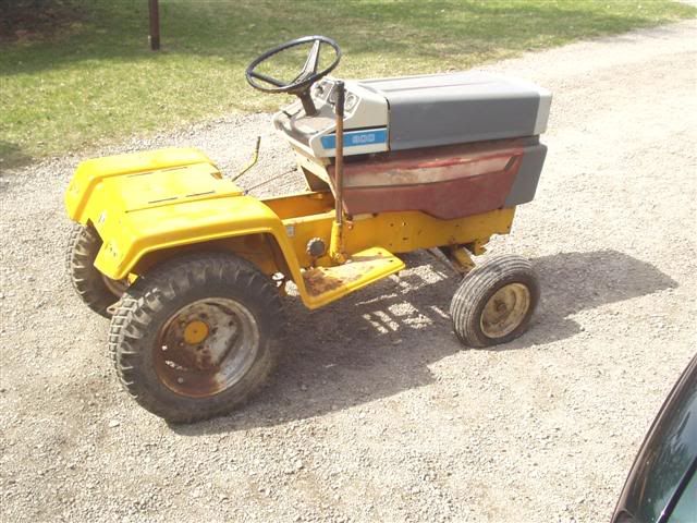

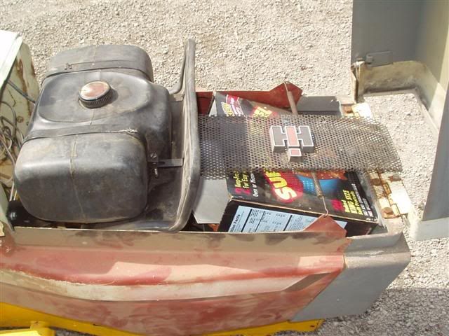

The 800 is the lowest production IH Cub Cadet built. When I purchase this one it had no hood, grill, side shields and motor. The 800 has a few special parts that are only used on the 800. They are the air cleaner, starter, pto clutch and muffler and part of the muffler box. Those parts didn't come with the 800 when I bought it. Over a few years I found the special parts to keep the 800 all orginal. Most of those parts are in that pretzel box.
This is what the 800 look like before the restoration started:
http://i152.photobucket.com/albums/s.../800/80006.jpg
http://i152.photobucket.com/albums/s.../800/80004.jpg
http://i152.photobucket.com/albums/s.../800/80002.jpg
http://i152.photobucket.com/albums/s.../800/80005.jpg
It is easier to move the 800 around and keep the special parts for it in the motor compartment.
