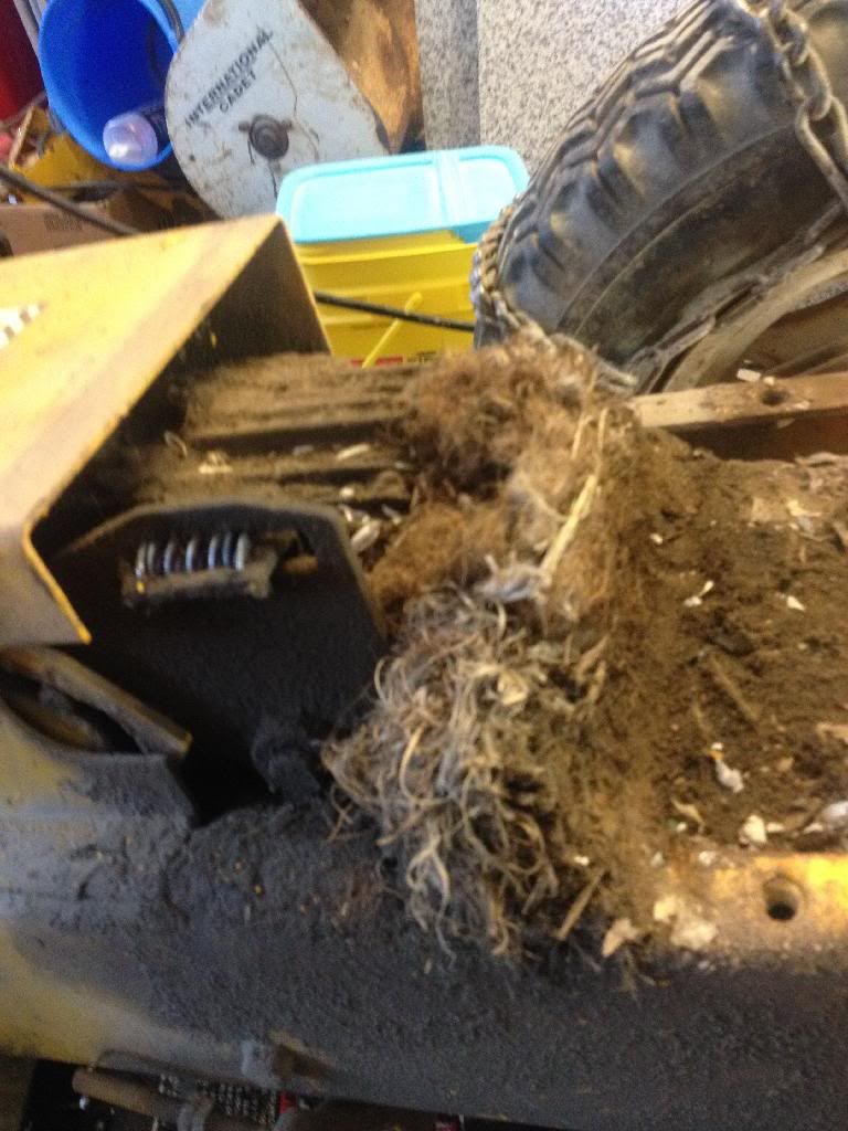

http://i288.photobucket.com/albums/l...psh6gfdvdz.jpg
Magnum 02-18-2014 12:50 PM
Originally Posted by TheSaturnV (Post 244226)
There was so much junk built up I think it may have been holding the throttle bracket from going all the way. I'm glad i tore it all apart to clean it up.
PaulS 02-19-2014 08:59 PM
Wow I'm thinking a beaver could live in that mess.
