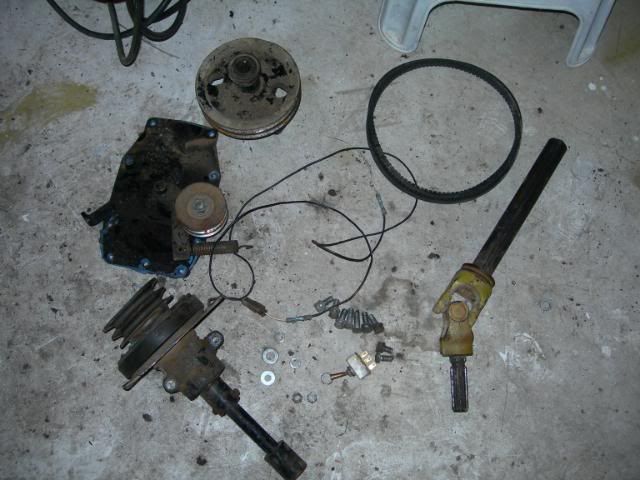

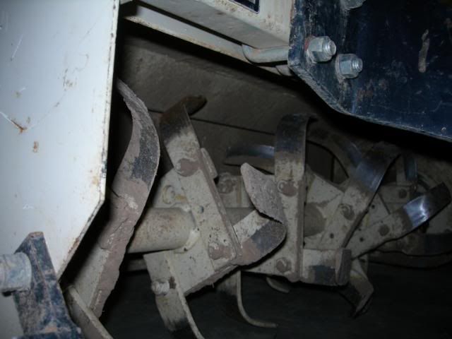

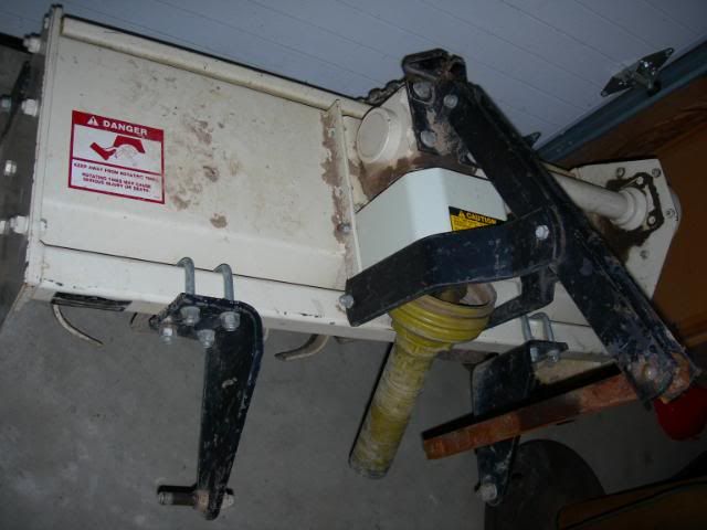

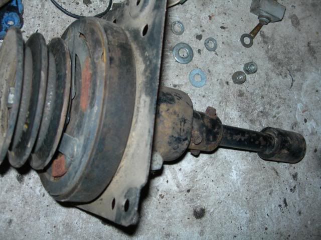

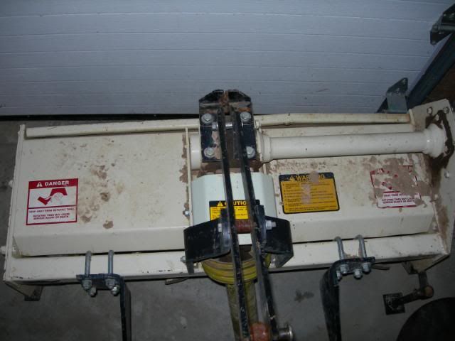

A few quick pics from earlier today.
Tiller
Rear PTO & Tiller Shaft
Rear Plate for Alum rear end Looks easy enough to fab up the mounts on my CI plate.
I have a little cleaning & lubing to do. I wasn't aware that the rear PTO switch, wasn't really a rear PTO switch. It's actually a selector switch to choose the front or rear pto and the front PTO switch will activate the one chosen. I'm glad I got the guy to get it off the tractor for me before I left. I'll have a little wiring to figure out also
Now I'm just waiting on confirmation of my order for the 3 point.
Better pics when I dig in to this in the near future.

Scott - how does yours work? That info is basically straight from the PTO manual.
Page 15 of the 433 Rear PTO manual calls it a "Directional Switch". I'm not married to connecting it this way, just what I found. There is also a "Wire Lead" (3 wires) provided with the kit, that I don't have and looks to provide power thru one wire and then the appropriate switch wire to the PTO's.

Your wire harness should have the option built in so it shouldn't be an issue.
Mine has two independent PTO switches, one does not effect the other.
BTW I rewired another tractor this last weekend and I used a 'protected' automotive switch for the pto.....and after mowing with it last night I'll have it NO other way from now on...absolutely hassle free.

Your wiring harness should be already wired for the rear pto. The plugs for the switch should be under the dash. The plug for the safety switch should have a jumper wire in it already. There is only one wire for the pto clutch and you should be able to find it at the rear of the tractor under the fender pan. Or at least that's how my 982 is wired.
