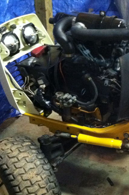

How close does your air filter bracket com to your glow plugs? Mine are closer then what I would like to see. Not sure if these are taller.

Mine bolts to the two eye loops for lifting the engine and sits above the valve cover. It should have plenty of clearence
