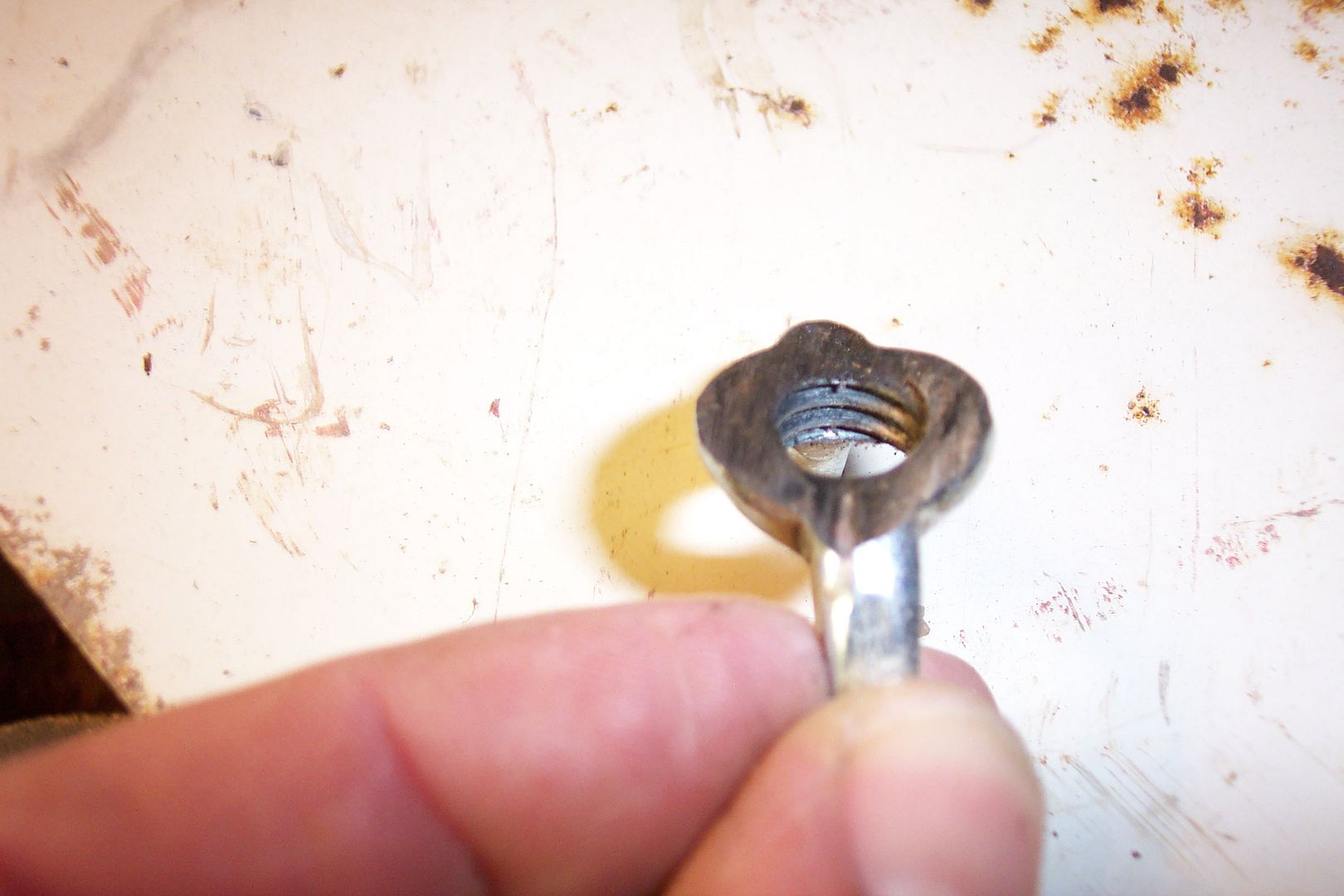

Could you get the dimensions on the threaded rod and the adjustment handle?
I went "mickey mouse" on mine.
A ground 1/2-13 wing nut, a piece of 1/2-13 allthread welded to a piece of pipe with a bicycle seat mount to secure it to the chain
rust has made mine one piece. I was going to ask you to make me one. if it junk. I'll get you better pics and sizes so you can make it.
