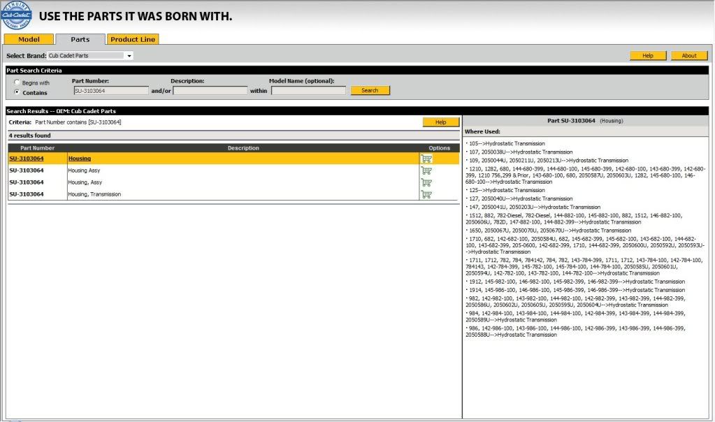

I have both rears cleaned up and ready to install and test... Or so I thought. I really want to keep the 107 IH rear, but need the 1811 ported pump. Anyone know if I can just change the pump section from one trans to the older one? Heres some pics. Side by sides too. The yellow trans is from the 107 the black is the 1811. Pics of the charge pump gray colored are the 1811 pump. If I can trade out the cam plates that may be another option, and Ill keep the 1811 rear intact. What do you guys think?

According to the Parts list at Cubcadet.com it is the same housing:
That is the 1811 part number referenced to other things it will fit.

You're a Wonderful person!!!!!
