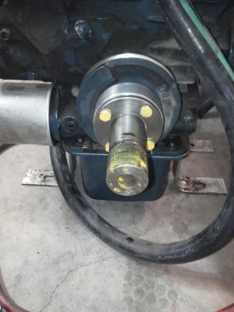

I got one complete engine and one in parts (spun rod bearing).
Adapter machined for the drive. The adapter is dowel pinned to the crank pulley and held in place with the main crank bolt.
Drive shaft adapter fitted.

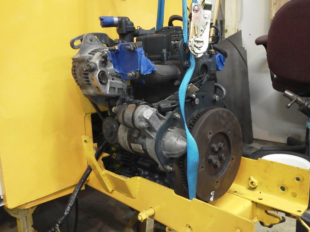

First test fit. I'm happy to say it will clear the stock front cross member on the frame once the "bell housing plate" is trimmed.

Got the engine positioned right where the Kohler was and mounts welded up.
Test fit hood. Going to have to do something around the alternator bracket.
