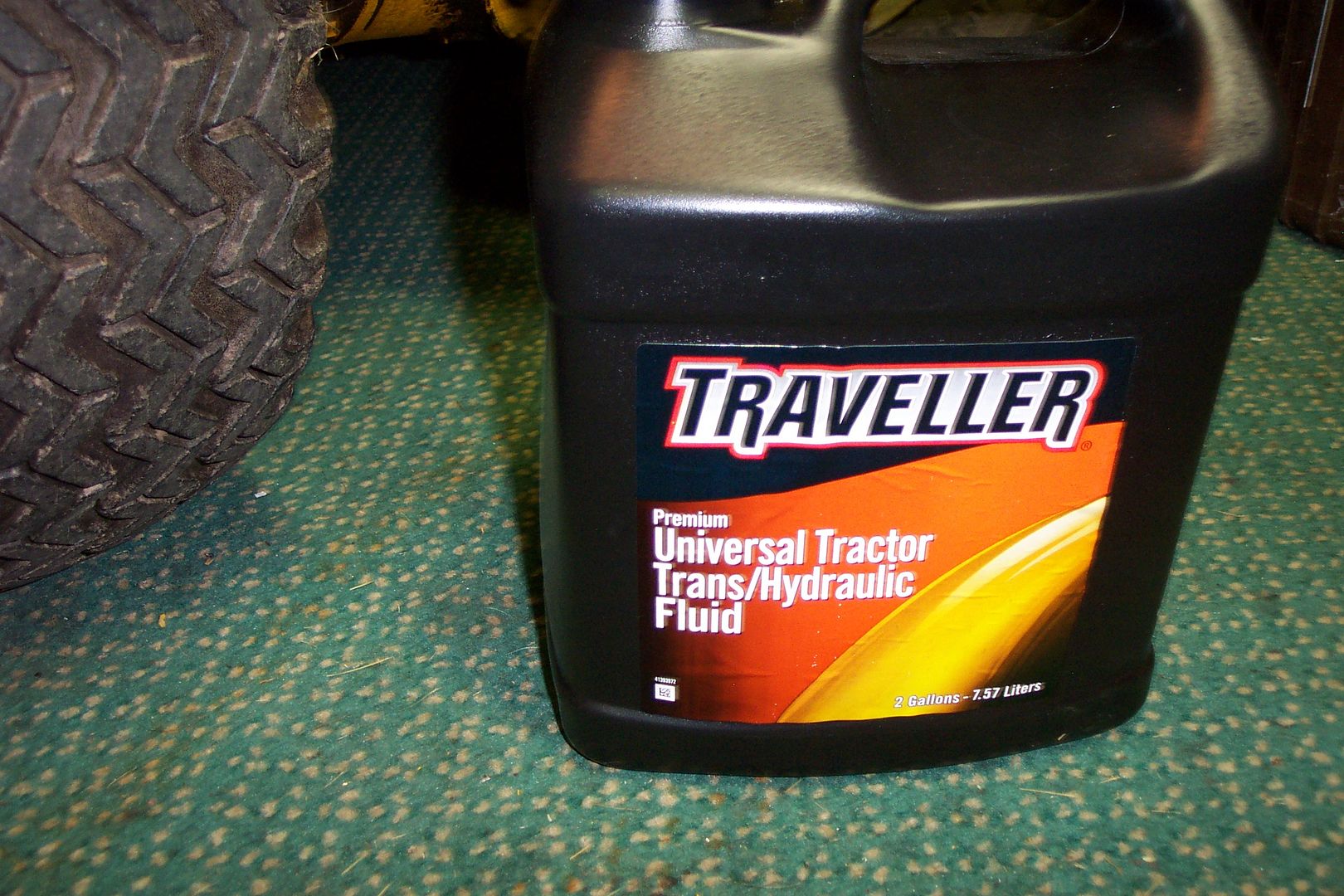

Originally Posted by DirtRodHillJack View Post
I know there's been a lot of debate on this. Not looking to create a debate thread.
Need to put fresh oil in the creeper & trans of my 100. The 70/100 manual calls for hy-tran (obviously "hytran-ultra" would be overkill for an non-powershift unit).
Bemoaning the cost of hytran, someone recommended just running 80w-90 gear oil instead of hydraulic fluid. Anyone ever do this on their cub? The 80w-90 doesn't look real cheap either.
Just curious.
I went to Tractor Supply ( TSC ) and purchased this. Hy Tran equivalent
click for bigger pics

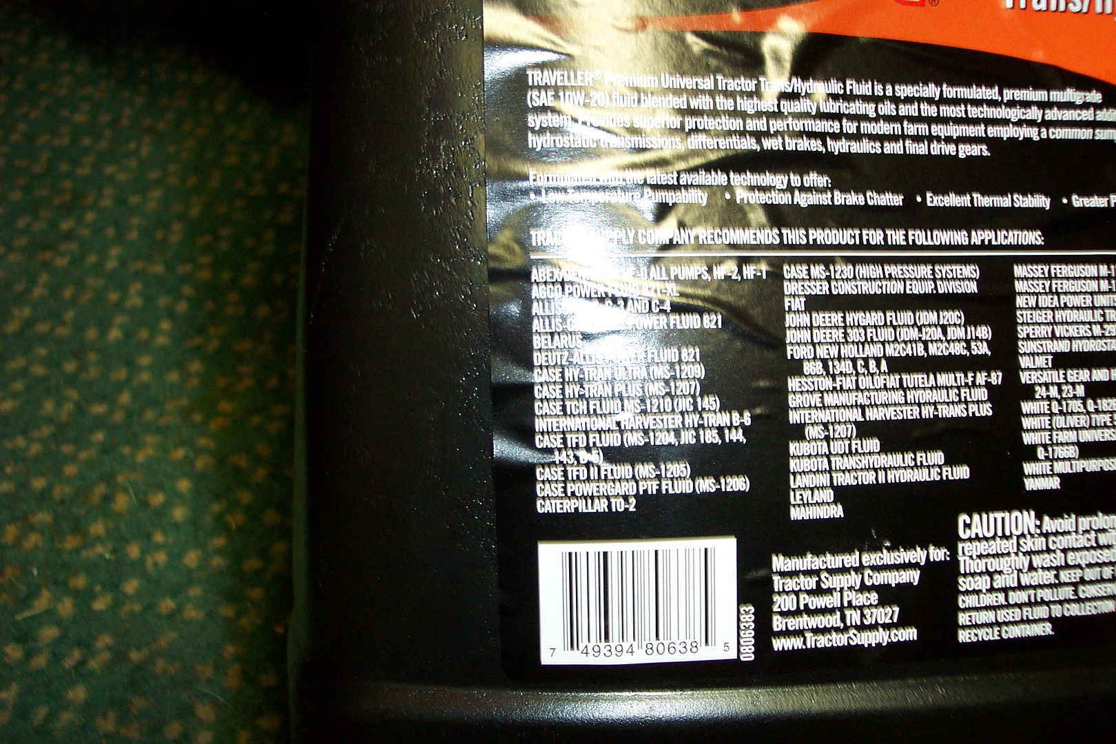

I wound up going with the same stuff. I'm confident Traveler Premium will work just fine for this task. For all I know, it's probably good enough for some older farmall row crop tractors as well. Local IH dealer wanted $18/gal for Hytran. No Thanks.
Alternatively, I couldn't narrow down which NAPA fluid was MS-1209 compliant. And the guys at my local napa aren't very helpful on such things. So, TSC it was.
I think eighteen bucks for a gallon of Hytran is a pretty good price. Hytran is what I would use.
That being said, it is your tractor and you can do as you wish. Most tractor fluids have an IH B-6 spec, so you should be alright with a gear drive. 80-90 oil may be a little thick for very cold weather if you operate your tractor year-round.
