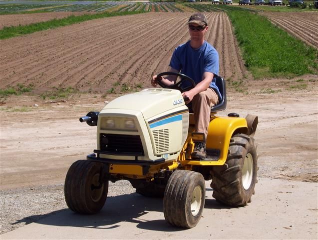

SGT tractors have a longer frame, heavier/ wider front axle,lower gearing in the hydro, bigger tires,and other than the 982/1912/14 all come with turning brakes and power steering standard. They also offered 2000 rpm rear PTO on the supers with three point.
In this pic you can see how much bigger my 982 SGT (far left) is than the 1811 with the snow thrower (normal GT)
