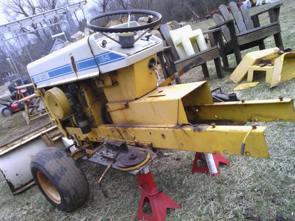

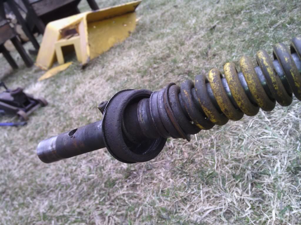

The throw out bearing decided it know longer wants to stay together lol
The problem
882 diesel, x3 ih 582, 73 124, x2 82 seriers pullers, 1686 16hp puller
Old 04-07-2013, 08:55 PM

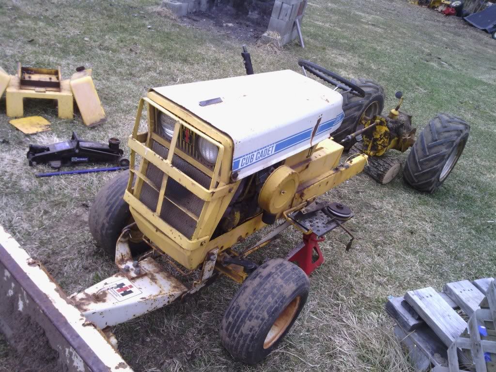

Looks like it blew the rear end off it.

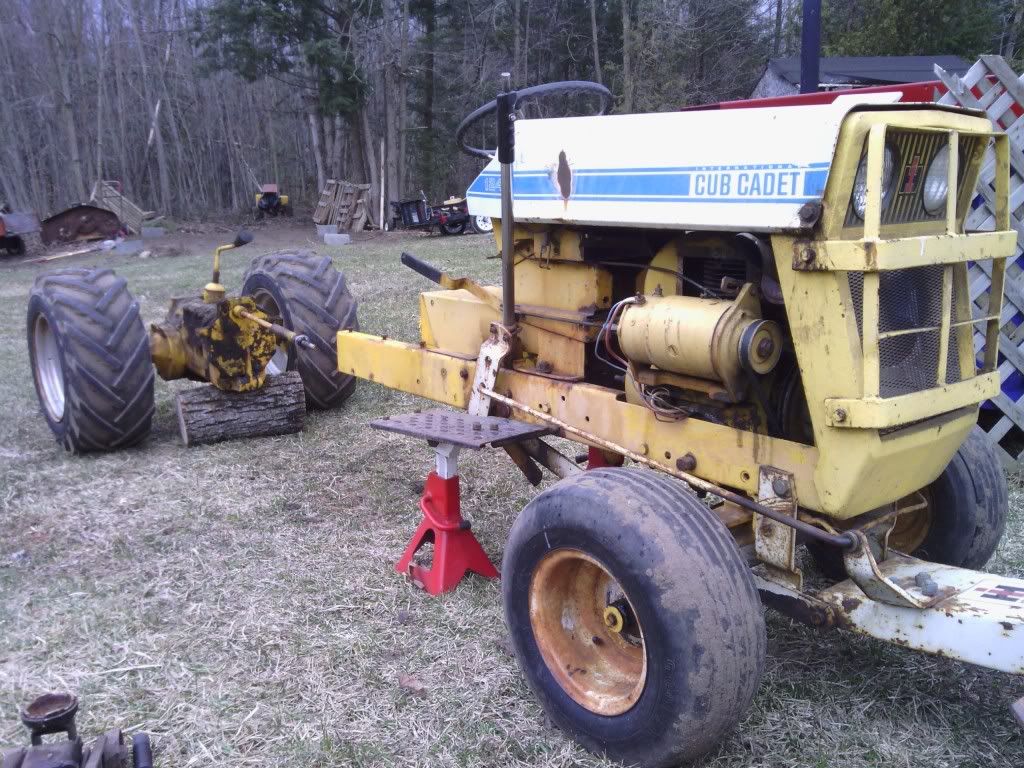

Lol was the easiest way for me to get the clutch out. Darn roll pins!

PBlaster and a bigger hammer. Make sure your ends are not rounded over.
Old 04-07-2013, 10:01 PM
Looks like the throw out bearing has seen better days.,
Hope it all goes back together easy for you
I found it quicker to pull the motor and the clutch comes out hole and then try and pound out the role pins. What ever you do don't put a role pin back in.

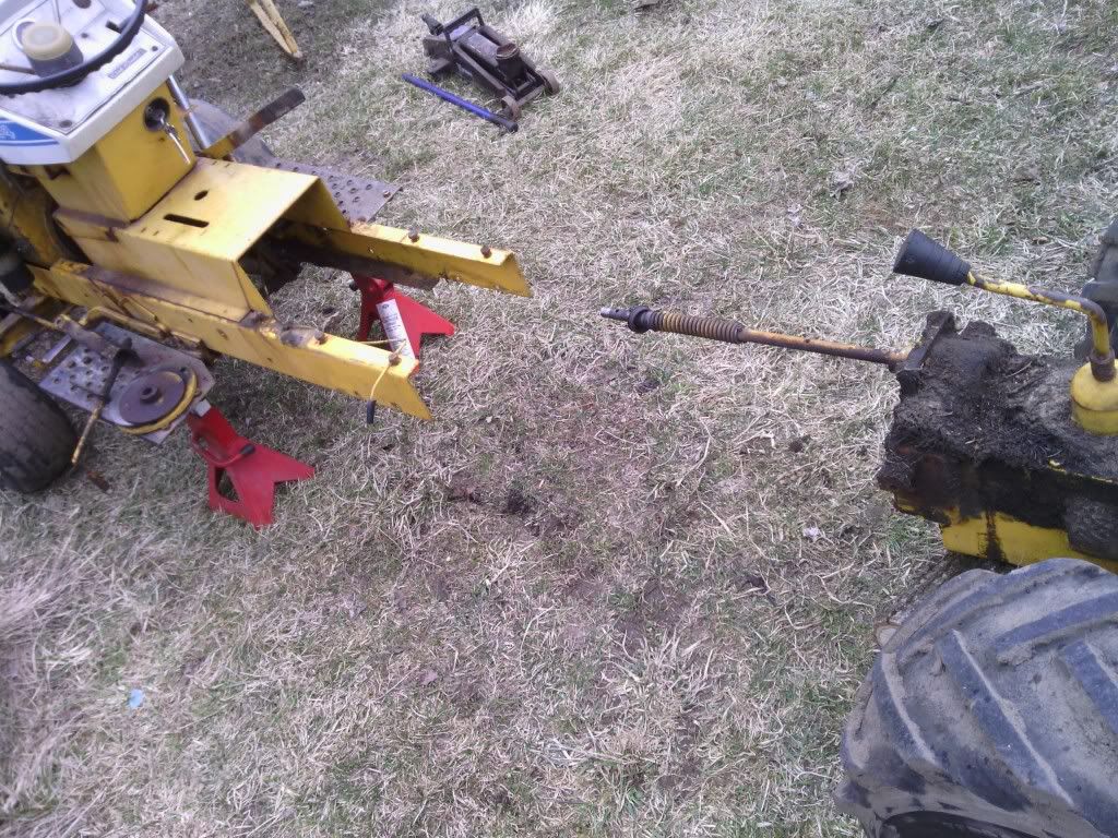

Maybe some one can help me... i saw a tool on ebay to press the spring on the shaft to put the roll pins in. I no longer can find it. Does anyone know a webside that sells it?

Not sure on the tool but just fyi you can remove the engine and use the release arm to hold the spring back while you knock in the pins. Use a jack stand or something to support the front of the drive shaft. Nothin to it.
Try this, click on tools http://mgonitzke.net16.net/
PDF download of the tool
http://mgonitzke.net16.net/tools/compressor.pdf
