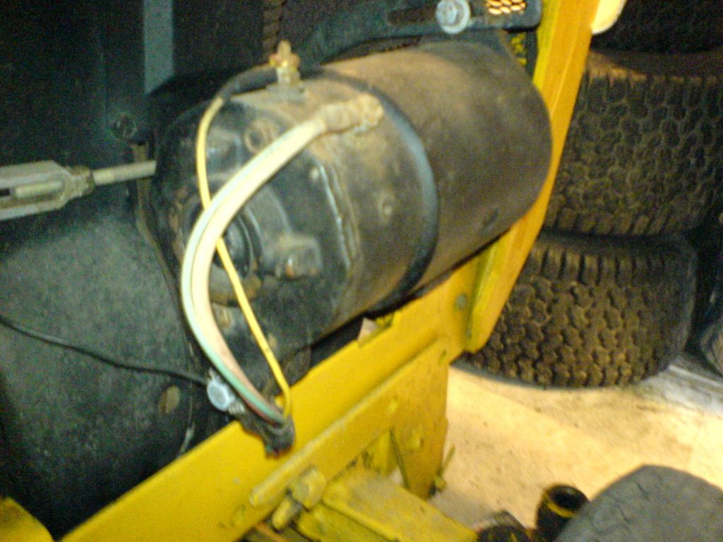

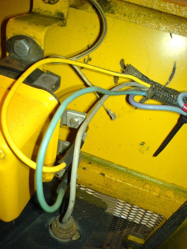

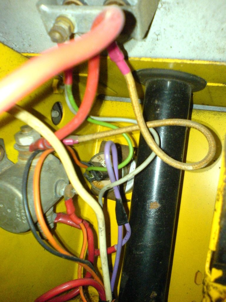

Welcome to the site!
Now some pictures.This is a 106 same has the same harness as the 127...

Good point drglinski, I already have a Battery Tender on it while it sits and put some ethanol neutralizer/fuel stabilizer in with every tank but, seeing as I use it primarily in the cold, will start running lighter oil in the winter.
THANK YOU DARKMINION!! That's what I needed and that is the wire I thought. Now I can remove all of his crap and put it back the way it's supposed to be! Hopefully I can tackle the lights too, anyone know why I would have what appear to be factory lights but no switch? I will take some pics tonight when I go out fix the wiring, fire it up (hopefully), and clear the driveway (hopefully) so you guys can see what I'm looking at.

Glad I can help!!
Now don't forget those pics you promised us !!

Hopefully the pictures Lew sent you will get your wiring figured out.
I hope it's not your ACR, I remember when I bought my 123 the PO had a car battery hooked up to get it to crank over better. (Let's hope it's just a ground issue
