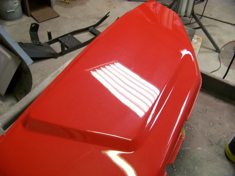

I put the side cover on a heat lamp for 30min after it was setup enough to touch it.
let it cool for an hour then color sanded it with 1000 grit then 2000 grit. looks like red chalk
then buffed and polished it. you can see the metallic in this pic
sorry to all the purist's, but I do like the look of stock. with a twist.
like my trans am. GM never did a white and gold TA in 79. so thats how I restored mine.
the slite color difference in the frame and cover is fine. you see it more from the flash from the camera then just looking at it. I didnt want it spot on any way.

this aint no queen. it'll see its share of work, thats for sure. its killin me now that its not running. but the 125 is filling the voied for now. I put 4 coats of the clear on it so I can wet sand any scratches out, that it WILL get in it. its still just a tractor, just going to be a very nice looking tractor. I just might not mow close around the bushes anymore with it.
