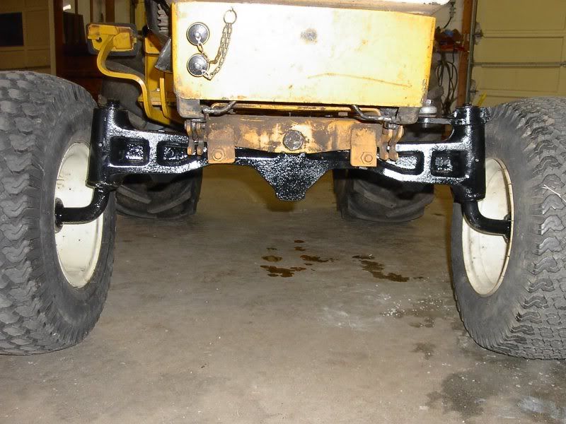

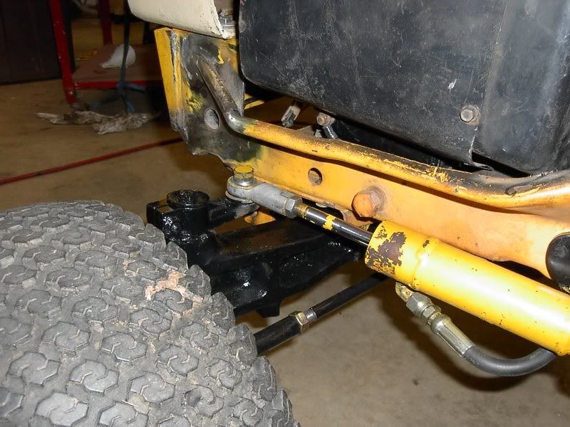

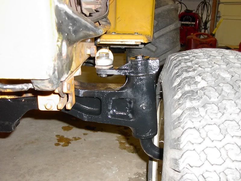

I took the wire wheel to all the axle parts and got it painted last night. I got it installed today and working. I didn't see any areas that appeared overheated of damaged at all.
I had to turn the steering arm upside down to keep the cylinder lower since the frame mount for it is lower than on a super. It was at to much of an angle. I tried mounting the cylinder under the arm but that didn't work either.
The axle puts the wheels more forward and gives it a wider stance, I like it.
