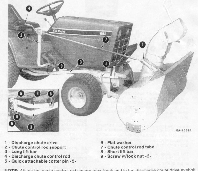

3. Is my Haban H42 snow thrower going to work on this? It looks like the quick release is he same as the 782, but what about the lift arm? The 782 has a arm with a hole in it, above the passenger foot board.
The 1772 does not have that? (This is actually a picture of the 2072 I used to have, but the 1772 looks the same)
