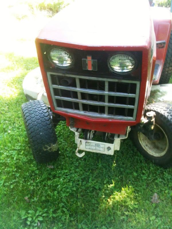

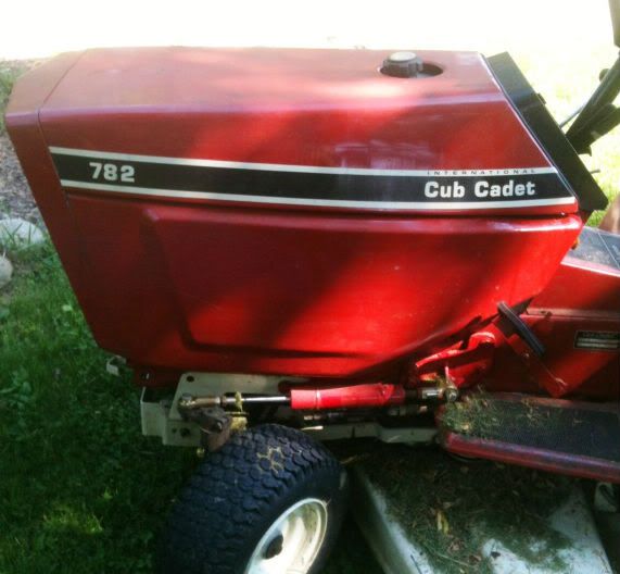

Almost complete with the upgrades to the 782. I must say I absolutely LOVE the power steering. We did quite a bit of yard work yesterday moving rocks and paving stones. Also pulling out underbrush from an overgrown area. My wife and son both spent time driving it and both commented on how much easier it was to drive.
I still need to make a couple of spacers for the front wheels, and redo the bushings in the spindles. I also need to debug the differences in the turning radius from left to right. (inspectorudy's tips)
Here's a couple of pics from yesterday;
Steering ram.
Front hydro ports, still need to order the caps.
Dual controls.
