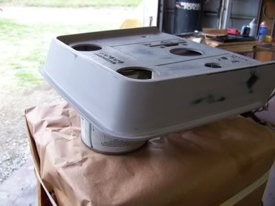

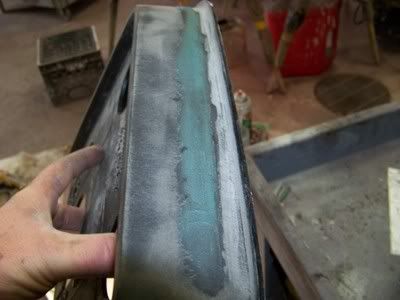

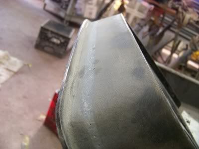

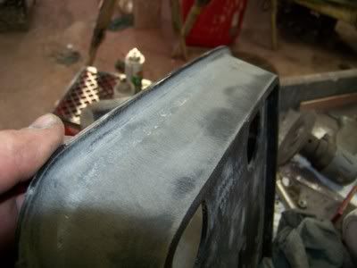

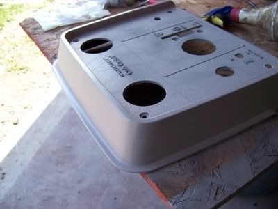

heres the fiberglass sanded, last pic is the glass filler I'll sand later then primer it and paint.
Doug

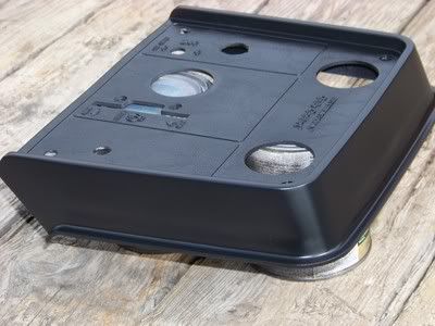

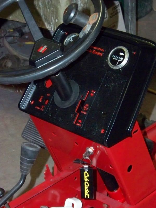

here's the dash in 2K primer
then wet sanded with 400 then 800 grit sand paper
then semi black.
Doug

and done, I like it.....
Doug

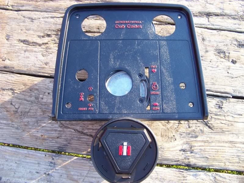

and last one. sorry I like pics.....
Doug
