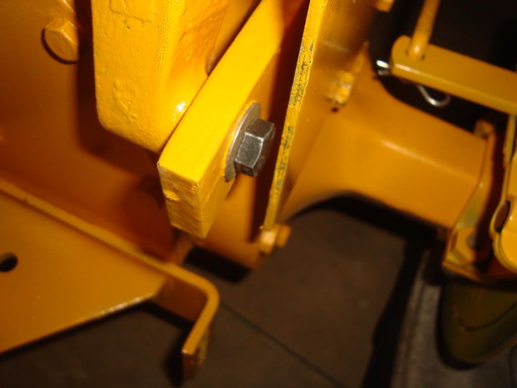

Originally Posted by westofb View Post
Looking great Dwyane!
I'd like to ask you a favor, though. If you get a chance could you take a close up pic of the bolt that holds the lift rod to the casting rod on the sleeve hitch. I was test fitting one on the 149 and the bolt head wants to rub the inside of the frame rail. I bought my sleeve hitch off eBay and am thinking the head of the bolt is too thick making it rub (the bolt I got with it is a new replacement, not the original), it also came with a flat and lock washer too..but if you put all those pieces on there, it won't come close to going inside the frame.
There is probably a 1/4" of space between bolt head and frame side.
Here you go westofb:

Thanks for the pics and congratulations on becoming a moderator!
My rubbing issue may have something to do with me test fitting them in the bare frame, perhaps the rear end assembly would spread the rails a tad. I am waiting on some parts to finish the work on the rear end, once it is back in the frame I will see if the problem goes away (hopefully it will).
Yes, actually mine frame did the same thing when I had it pulled from the trans. I am pretty sure trying to mate the two back together is what has gotten my back all out of shape. But the frame will spread open a bit, or at least, mine did. And thanks.

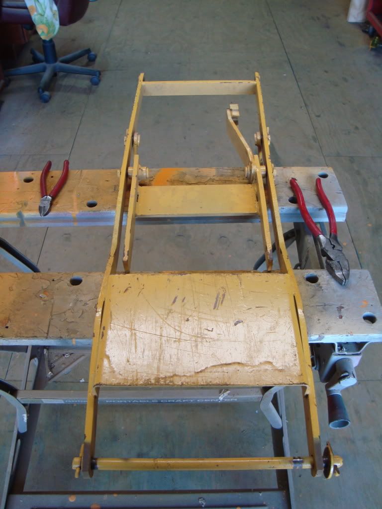

Still had some paint left and decided to pule the mule drive and subframe apart and get it painted up. Did a final sanding of the fender pan and a final paint job on it. White pieces will be done again next.
Sub frame before:
Parts drying after:
Clutch release lever:
Fender Pan:

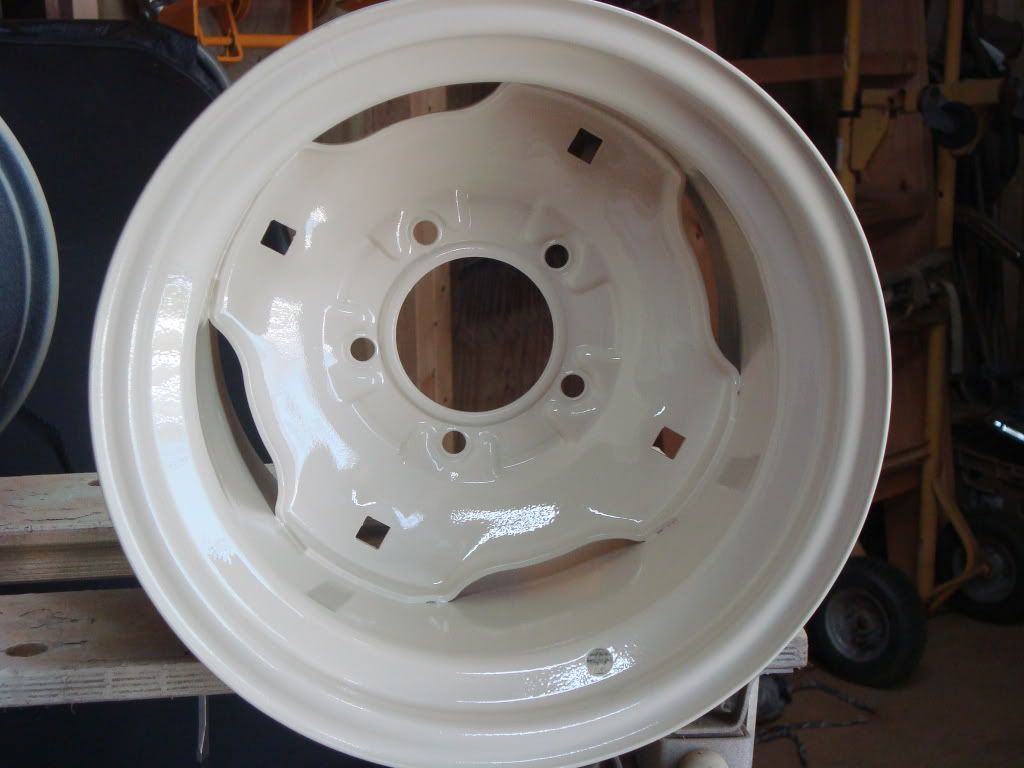

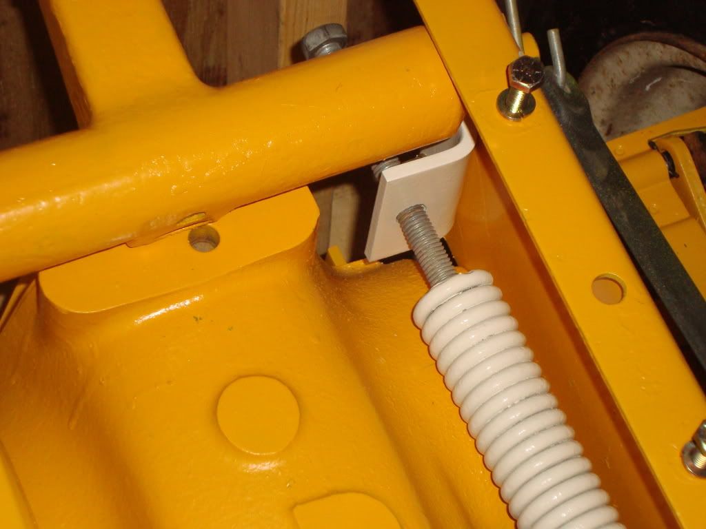

Well I got my spring assist cleaned and painted and installed. The gas tank and mounts mounted up together, and finally got the rear wheels finished up and drying. Now it's just a matter of $$$ to finish up the final things I need. A few more months but I am learning patience with this project.
Spring Assist:
OK, do I have the rear bracket backwards?

Rear Wheels painted this morning
Love that shine
