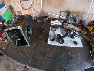

Well, I guess I'll update this again.
In just a couple hours, my "quick engine swap" turned into this:
I don't know how this engine ever ran in the first place!
Pulled the pan to replace the gasket, pan is aluminum. Engine has balance gears! Removed the balance gears, only to notice that the connecting rod isn't installed with the oil hole facing the camshaft! Fixed that, put the engine back together, stood it up on the bench and... "Clunk". The governor actuator arm fell off the governor shaft! so back apart again! All this, combined with 2 blown seals and a blown head gasket! How this thing ran is a mystery to me.
Fortunately I fixed the governor, and the engine is all back together on the bench again. At this point, I'm just waiting for the correct size seals to be shipped to the auto parts store and I can (finally) get this darn engine into the 107!
