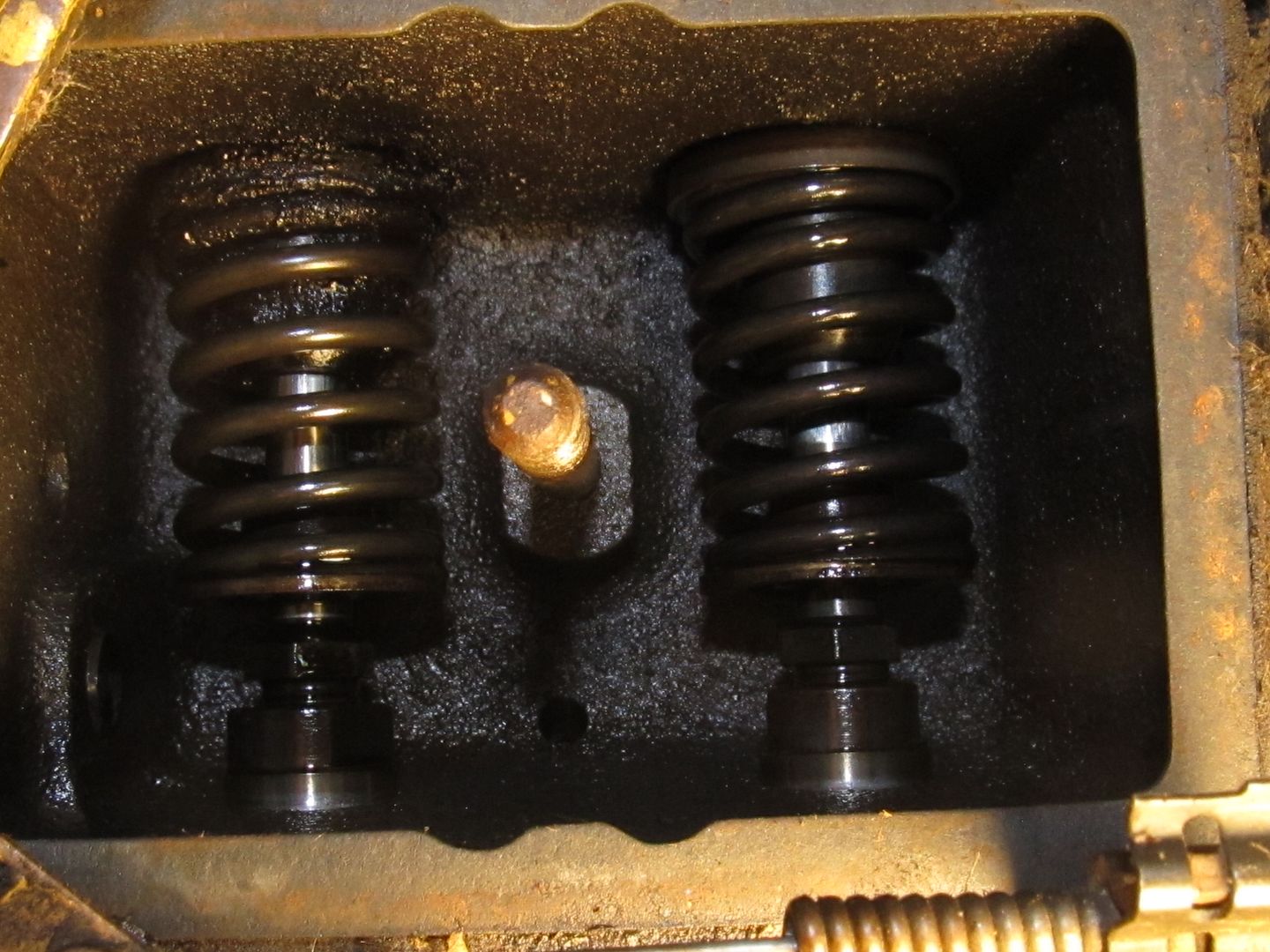

There is a lot of crud on the upper portion of the exhaust valve mechanism, as seen through the breather.

Here's the breather and crud on the exhaust side.
