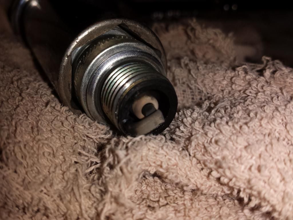

Ill try that here in a minute. There doesnt seem to be a whole lot of slop compared to ones ive seen. I used to have a 1450 with at LEAST 1/8" of slop in one direction. Also i pulled my plug again, its a grey/white color now which im thinking is too lean still? What color am i looking for?

To me, that looks ok-to-maybe a little lean. How long was it in there?
See J's thread on plug conditions:
