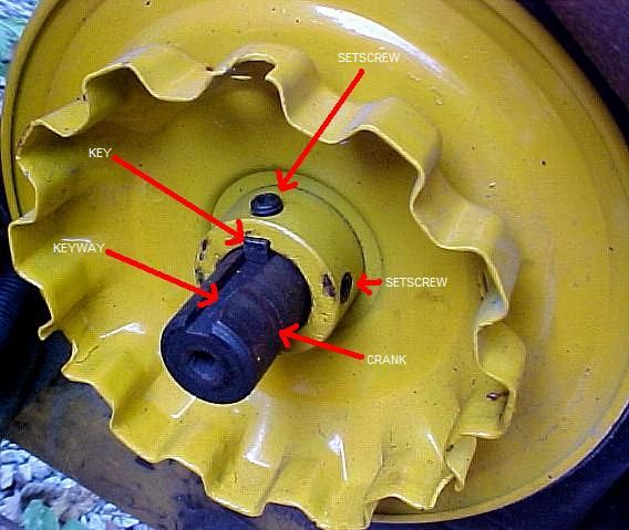

Old 01-21-2014, 11:20 AM
Giotundo Giotundo is offline
Join Date: Dec 2013
Location: MD
Posts: 41
I don't know the terminology. This is what I was talking about
the key has been sheered and is not square anymore. What is the proper name for this key.
  #50
Old 01-21-2014, 11:27 AM
cubs-n-bxrs's Avatar
Posts: 1,934
That is your starter generator pulley/PTO clutch basket. Nothing to do with other problem. Unless your hydro is locked up and starter sheared the key.
