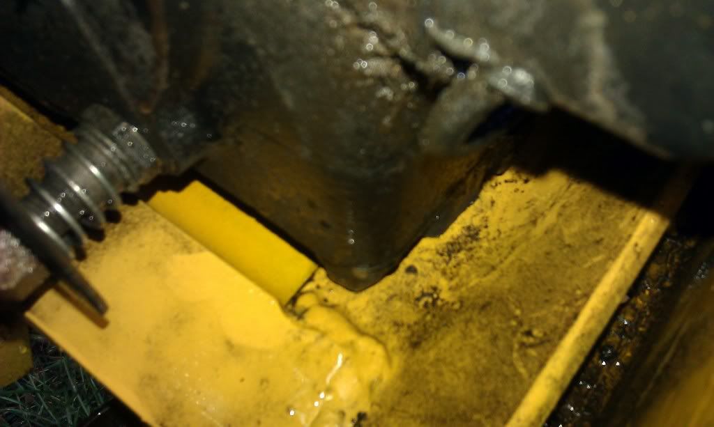

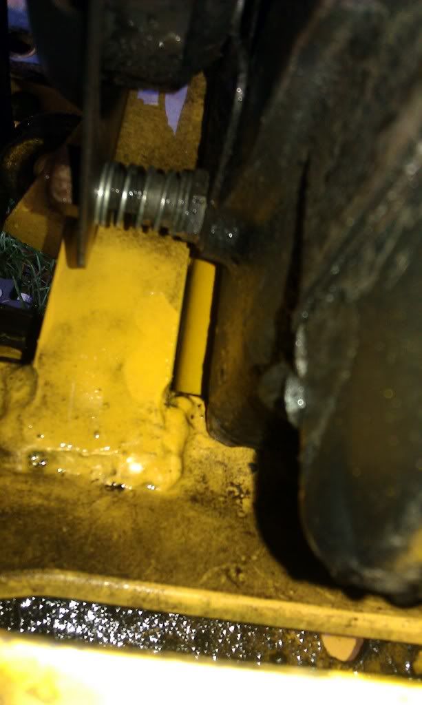

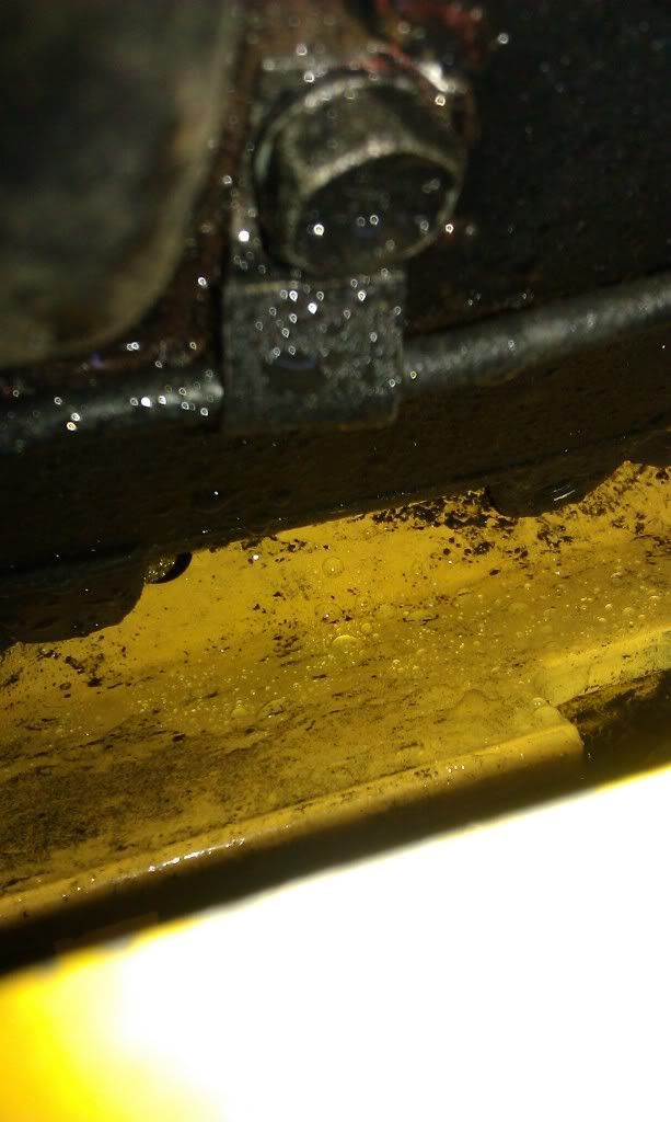

I can see the back 2 rubber ISO mounts
I can't see or feel the front 2 at all
Looks like a previous owner did the welding support bracket upgrade/weld the stabilize the 2 motor mount rails
This motor was removed for sure when it was repainted. With the care that was taken for that I'm surprised the ISO would have been overlooked.
Still stumped why I cant see the front ones at all
Also-how can I tell if the rag joints on driveshaft are not shot?
