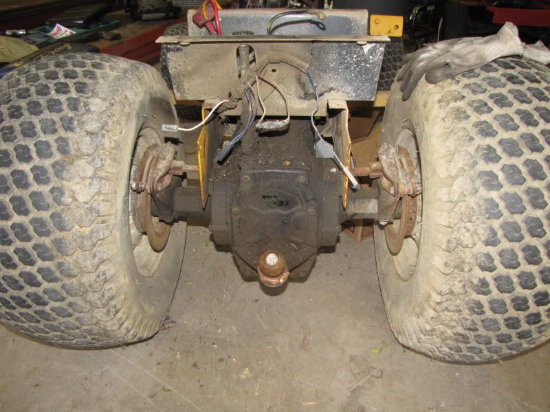

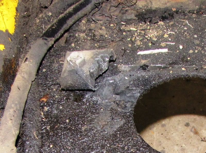

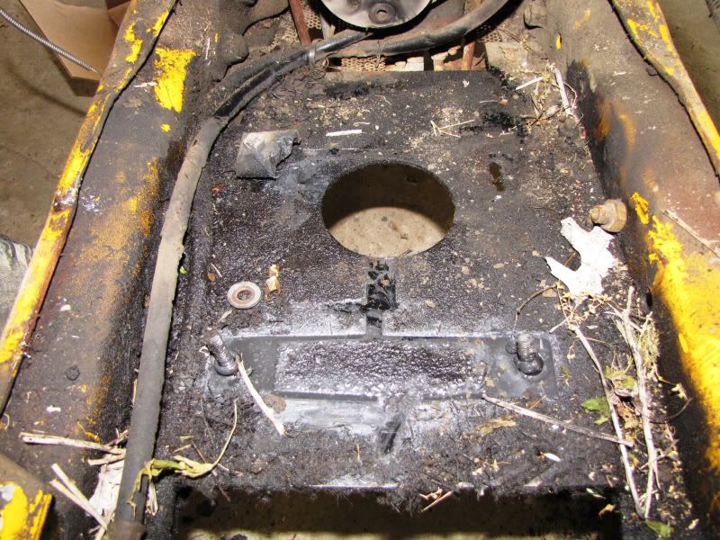

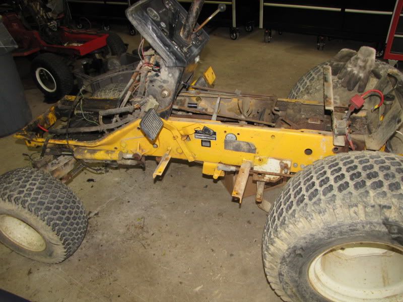

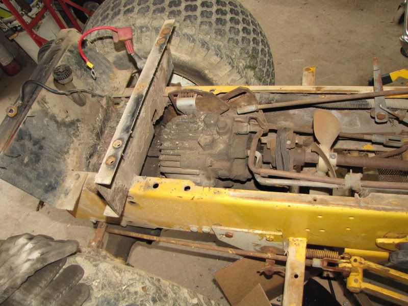

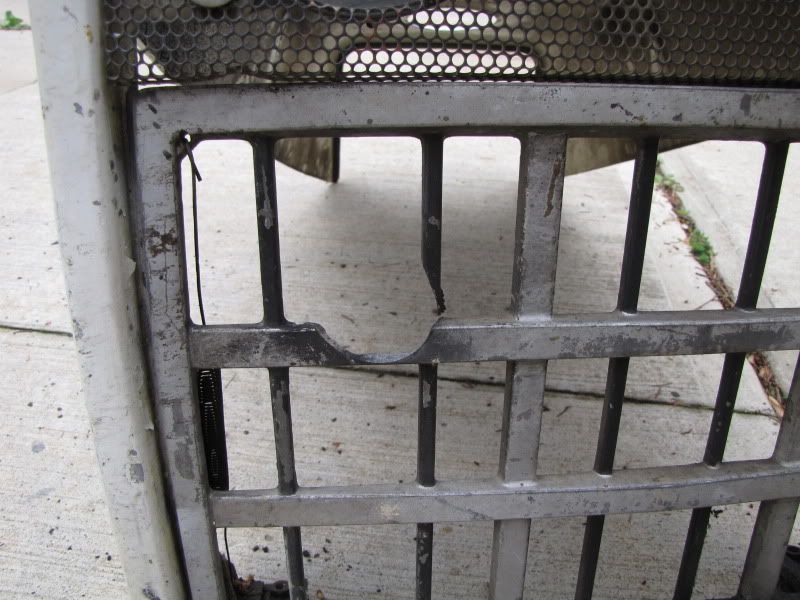

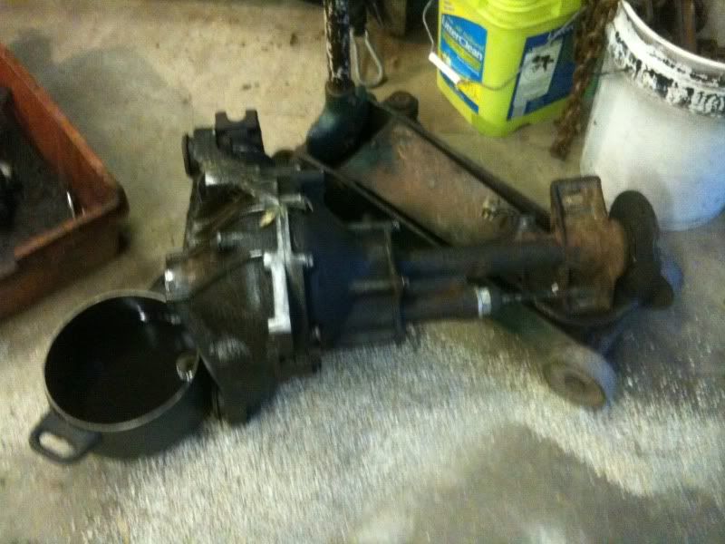

Began disassembling the 2072 last night. Here are a few pictures.
The most disturbing discovery was the fact that all of the motor bolts were gone. There was one left, but the ear it attached to broke off of the engine. I guess the exhaust rubbing on the grill should have been a tip off?
Hello. I just posted a new topic asking for info on a transmission control rod for a 1572. Looking at your picture of your 2072 (second one) I can see the control rod appears straight. I have what appears to be a bent one. Can you confirm that the rod ( the one that goes to the brake) is indeed straight? Thanks... Bob

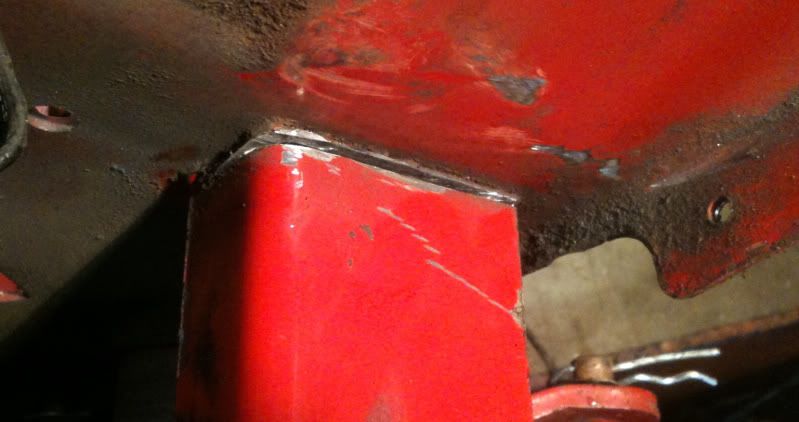

Spent a little time rectifing some defects in the power steering pieces. (I made them RED LOL).
I will need to source new "hiem" joints, and bolts.
Also got the KT17II ready to go back in.
Yes, that rod is straight. PM me if you need it, we can work something out. Thanks.

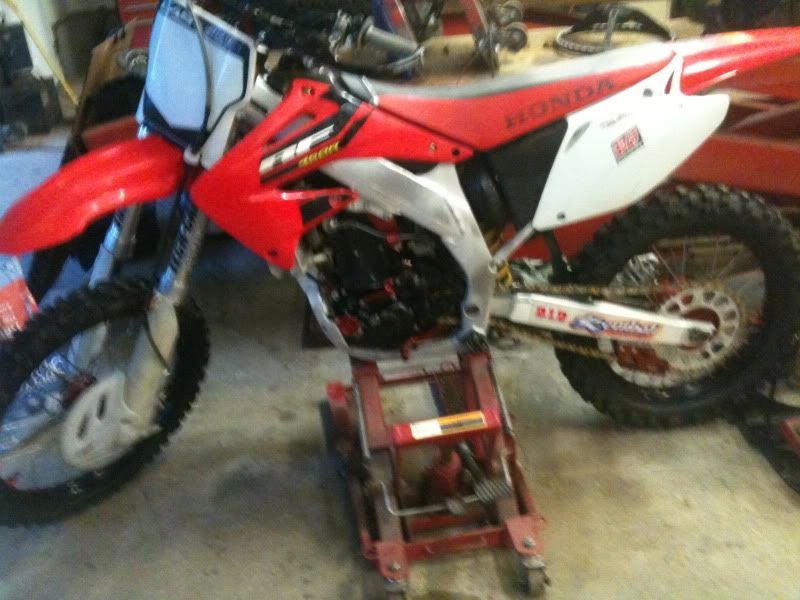

Then my oldest son had a crisis with his dirt bike. While changing the oil, hes realized the P.O. had stripped the drain plug, and glued it back in with clear RTV. So naturally dad gets the call. We pulled it apart and installed a heli coil in the bad hole. He is happy now.

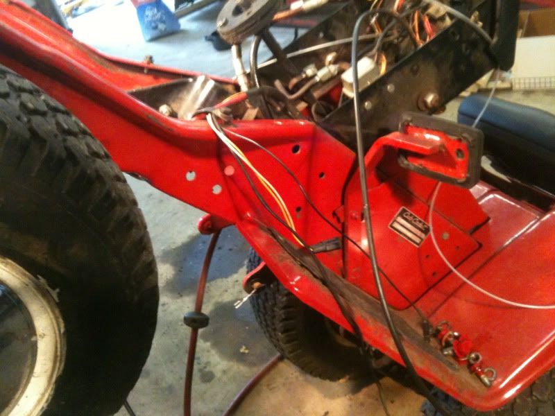

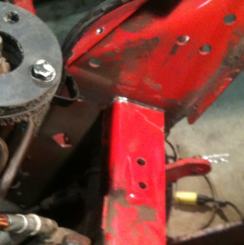

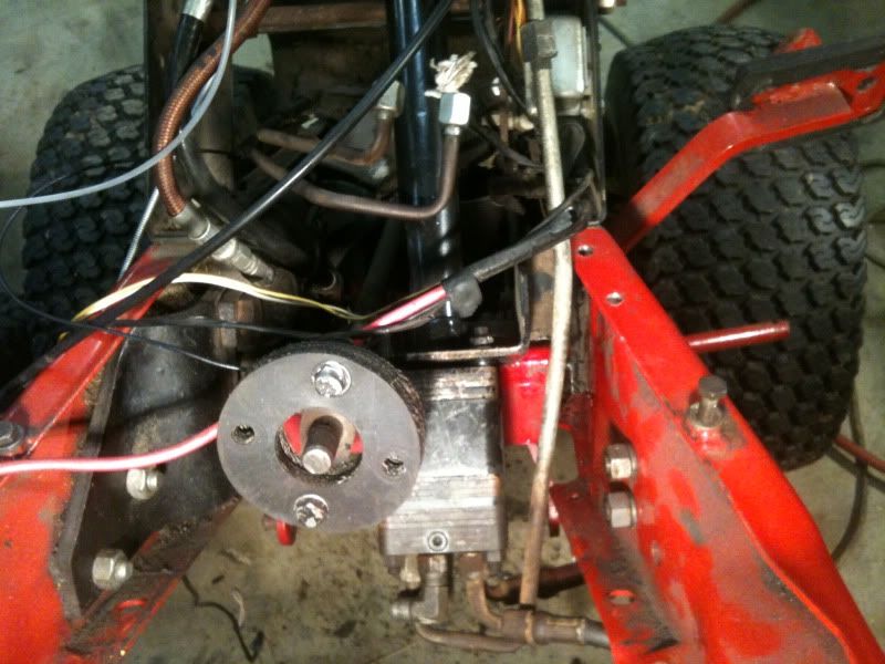

After all of that stuff, I was able to get a little bit of cub time in. The bracket that held the manual steering column in, was in the way of the power steering column. I had to do some surgery.
It's in now;

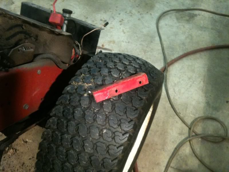

Next came the anchor bracket for the steering cllinder, this was in the was;
I'll relocate it when the fender pan goes back on.

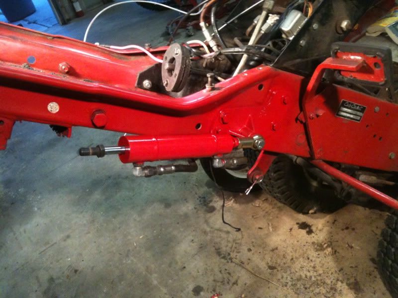

After I removed that bracket, I was able to get the anchor bracket installed.
Hopefully I can get more time in on it today?

Things are looking good! I made one small alteration to my PS ram and that was to turn it 90 degrees inward so that the two hyd fittings were on the inside of the ram instead of the bottom. They looked kind of exposed to me and it was no big deal to rotate them. No matter what you will be happy with it.
