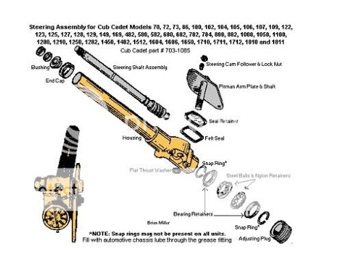

So if I use the old cups, it should be fine? I have the ones these cradles were in, and I can't see any difference from the ones I took out of the other column?
Remember, I am using parts from 2 steering columns? Here's a picture I stole from the net. It shows the retaining rings with the plastic cradles?
