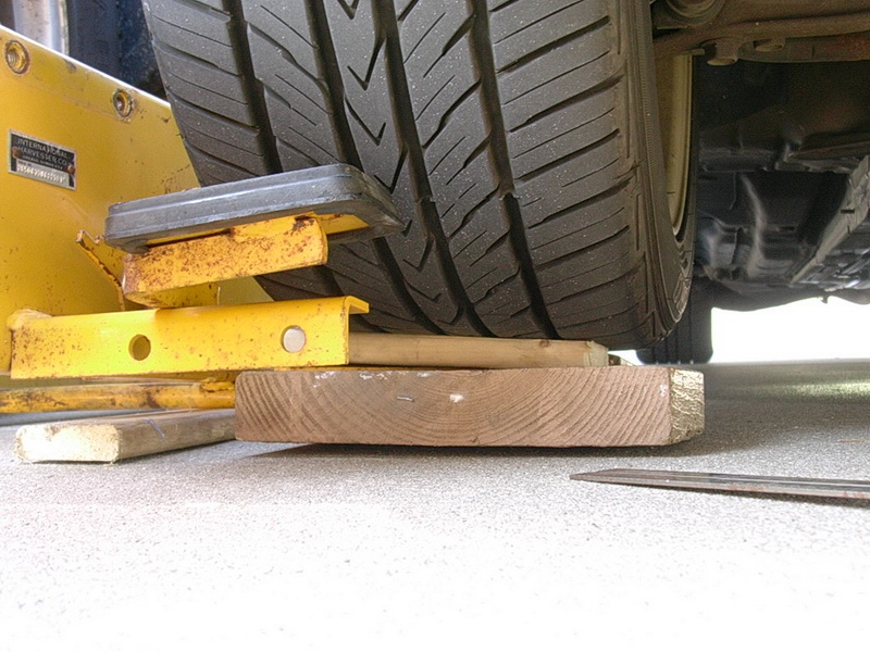

You guys will get a kick out of this.

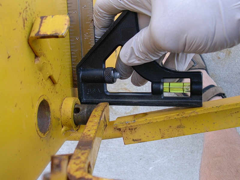

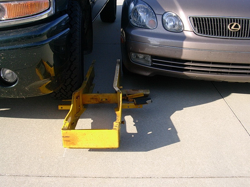

I have a bent footrest bar where someone jacked it up with a forklift at the salvage yard I bought it from. Here's the original picture of the damage:

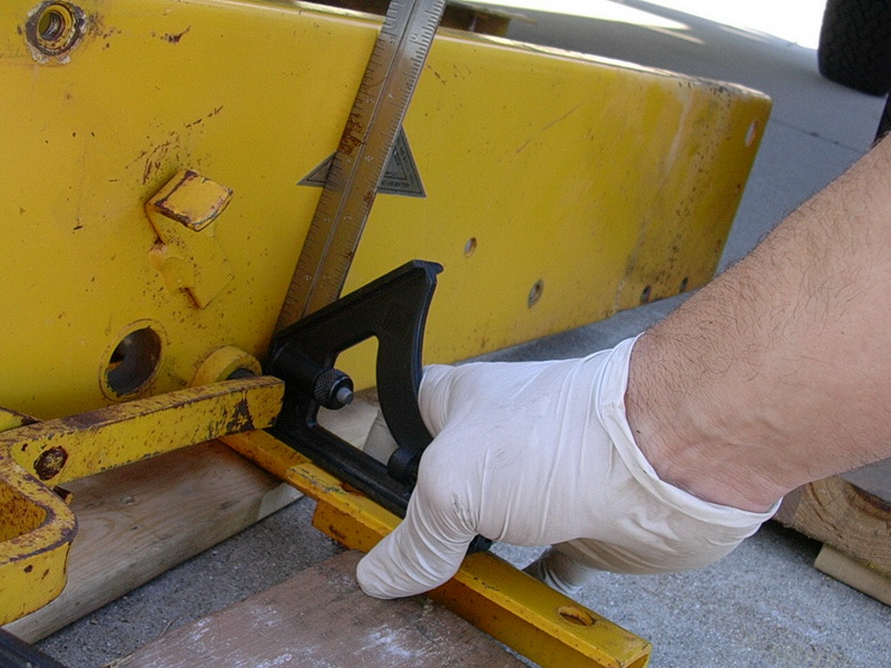

Here's how far it is off from square to the frame:
I don't have any torches to get that solid bar heated up enough to bend it back. I've been meaning to take it somewhere, but today I figured I'd try to bend it back without heat.

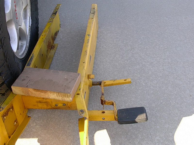

So I pulled my truck up on one side to hold it down:

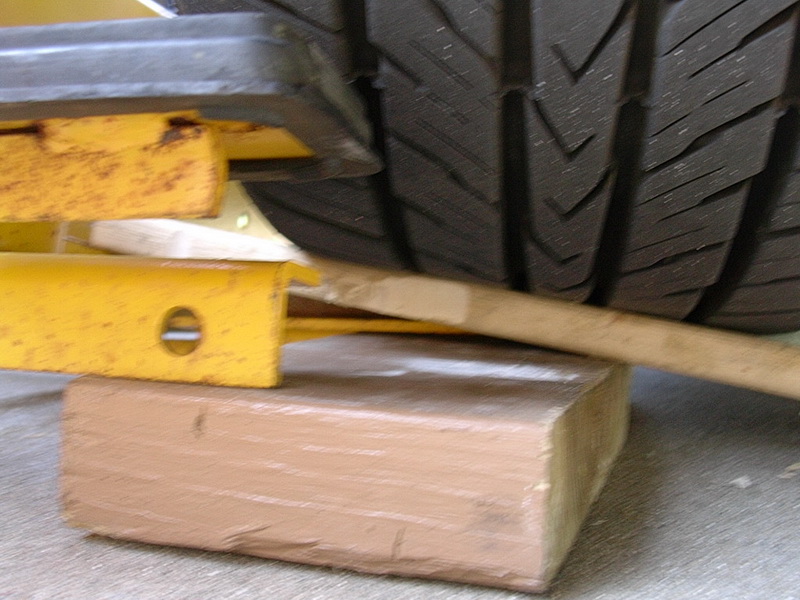

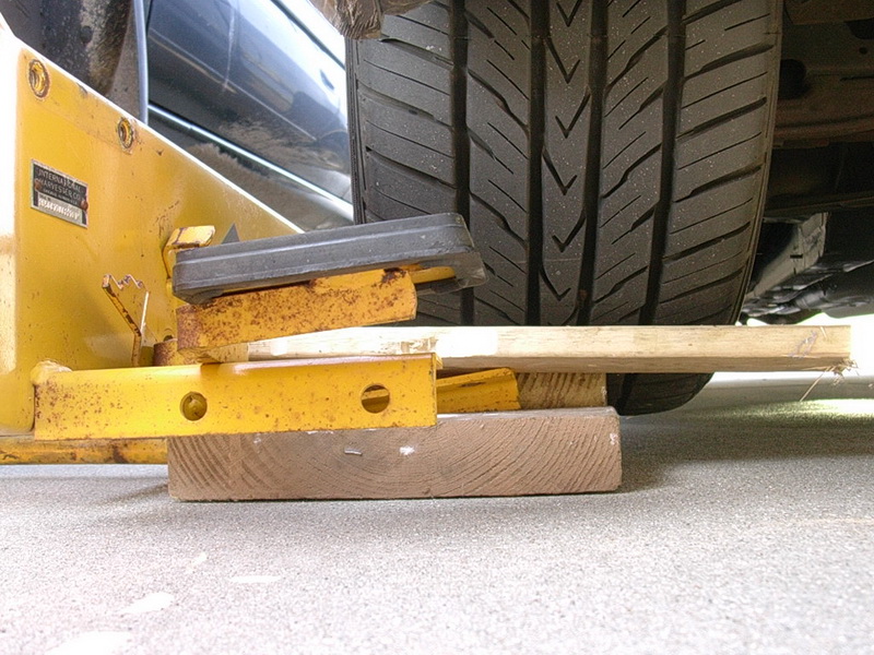

And here comes the car to drive up on the other side. I put a block of wood on there as a ramp, and used another piece of wood to protect the tire from the metal bracket.
Squish...
And now it's square. hee hee...where there's a will, there's a way.

Now that is some good ingenuity...

Thats using your head! I would have probably used a bfh myself!..lol Heah whatever works!

great idea on using what you have to get the job done.
Yea I really like having a set of torches in the shop now very handy!
Thanks for posting the details and nice pictures.

Now that's using your head Dave. I mean your car
