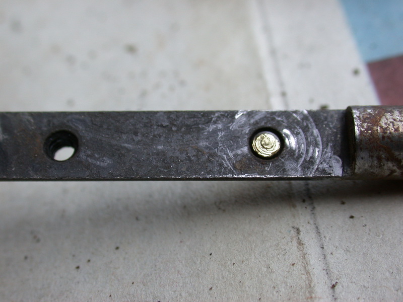

The K341 is back from the machine shop, but it doesn't look like I'll have time to get it put back together and ready to install in the 1450 for this weekend. We're heading to the cabin and I was really looking forward to tackling some high grass with it.
I have the new governor gear, shaft, and bushing ready to pick up tomorrow, which could have set me on the timeline. But I delved into the carb rebuild today and ran into two problems. As much as I paid attention to Matt's instructions, I still broke one of the brass screws off on the throttle shaft. I was cautious as all get-out, but it still broke. The other one was easy.

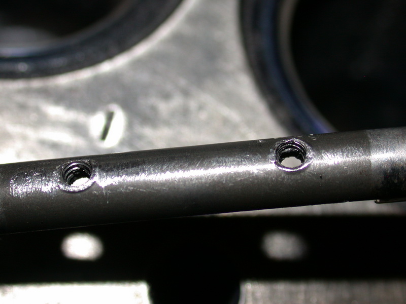

So I drilled out the remnants of the brass screw, but the 1/16" bit deflected and damaged the threads. It's all a mess now. I could re-drill and tap it to a bigger screw, but I'm just going to go ahead and replace the shaft.

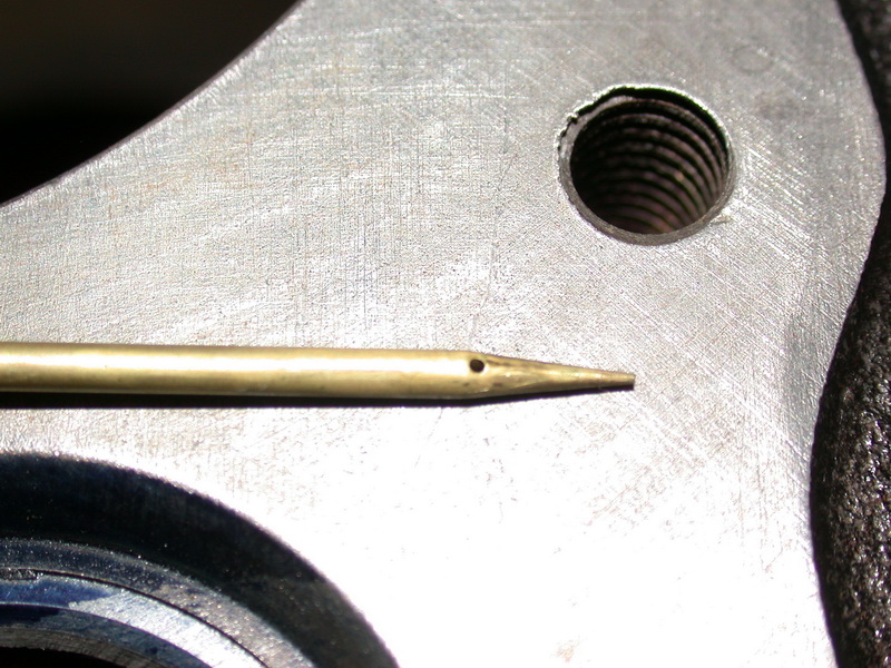

Also, I was cleaning the long high idle screw and found that it had a shard at the tip, so it needs to be replaced. A couple more items to order...

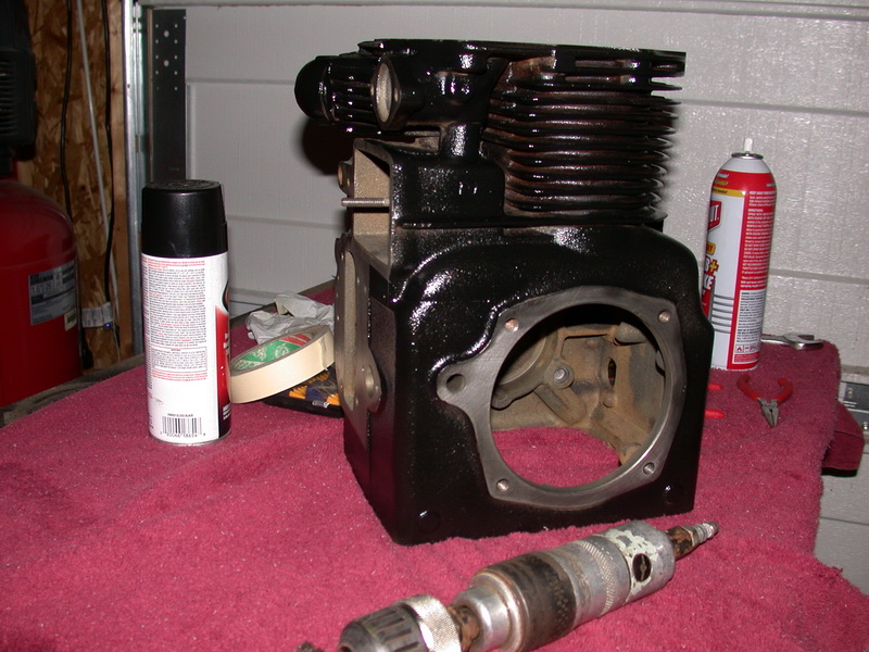

I did wire-wheel and paint the block, so there's some progress.
Broken throttle shaft screw:
Here's the ugly threads, they look worse from the other side:
You can just barely see the deformation of the high idle screw here:
And my purdy block:

Great pics! I stopped taking the screws out. Got tired of them breaking so now I just leave them in and make sure the butterflies are open when I soak then in the carb cleaner can. Now the fun parts begins!
  #294
Old 08-18-2011, 10:31 AM
I had to install the throttle shaft bushings to fix the slop in the shaft, so the screws had to come out. I did leave the choke shaft together for the dip.

Dwayne was referring to the detent ball/ spring that is on the choke shaft, I too got to spend some quality time rolling around the shop floor looking for mine as well. It is there to help hold the choke open.
Dave, those screws are staked on the back side, the exposed threads/ end of the screw where hammered on to keep them from shaking loose. I broke of 2 of the 4 originals (I looked at Matt's how to, but neglected to leave the choke alone, I removed it as well). I then ordered 4 replacements from Chris Westfall, kohler parts I think, they were the brass ones on his sight, then I managed to twist all of these off as well. So I am pretty good at getting out the broken ones, I used a thin cutoff wheel in the dremel to slit them and was able to use a tiny screw driver to get the out. Since these twist off so easy, I recommend you order some steel replacements, Matt says in his how to that he thinks they are #3x48 screws, and he is exactly right.
I think the next one I take apart for cleaning I will leave the choke butterfly in place, and to remove those brass screws, I am going to tighten them until they twist off, the use some small needle nose pliers on the backside and thread the remaining part out from the back, there is enough exposed threads to get a hold of and that way you don't have to fight the staking.

I dunno, I'd be cautious about breaking the heads off on purpose and then trying to get them out from the backside. That brass can twist and break pretty easily trying to grab it with pliers.
I almost think the best strategy would be to go in there with the dremel and grind away the peened end first, then back out the screws.
I don't think you can get to the backside if them without removing the butterfly first, after you twist the heads off, you can spin the shaft to access the back side. Then you can either grab them and thread them out, or cut a slit in it and remove it with a screw driver. They come out pretty easy from the back side.

You can use a small file and file off the peened-over end and then remove them. That is what I have typically done. I have also twisted a few off; I suspect the original installer got carried away once in awhile and over-torqued them. It wouldn't take much.
