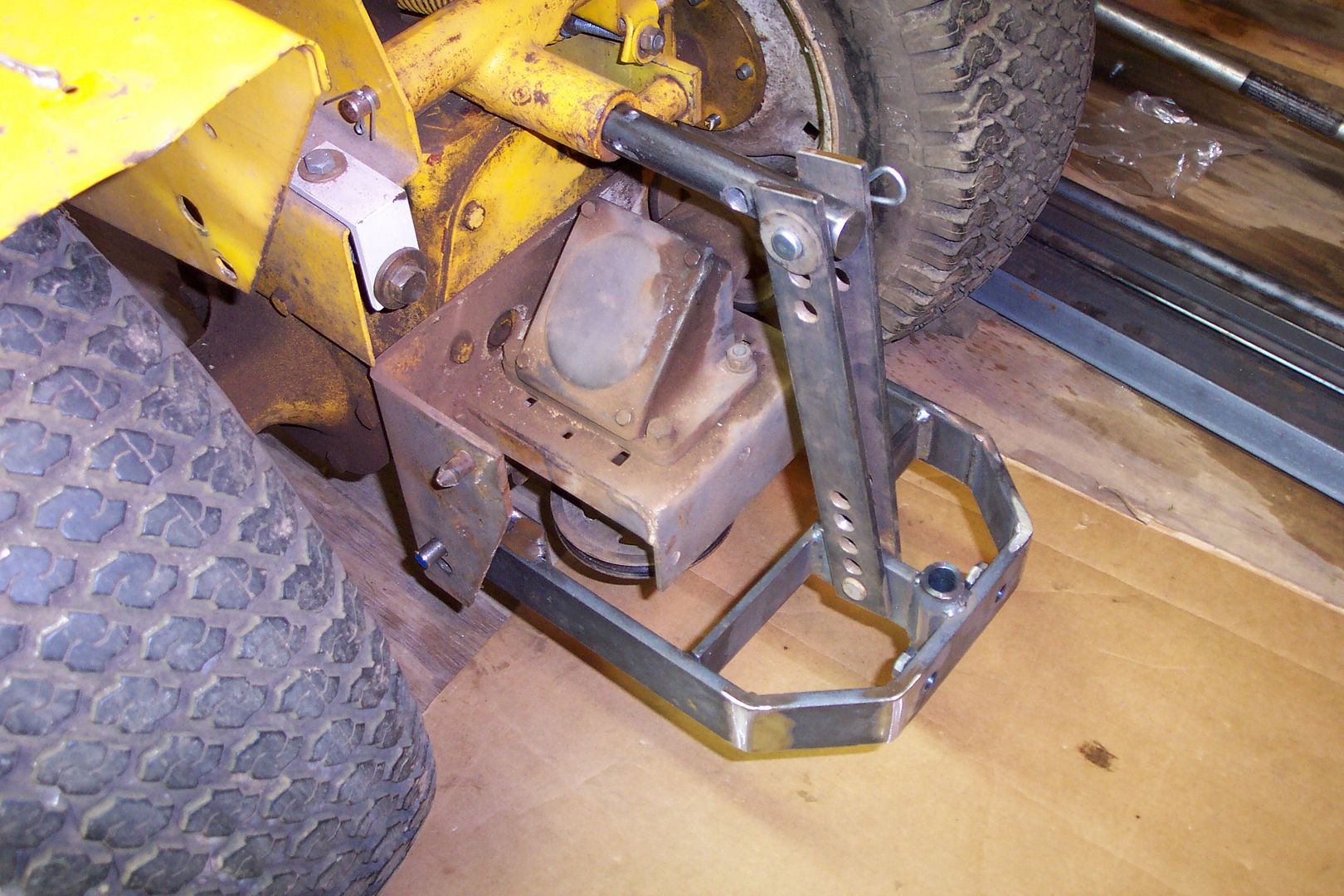

I REALLY want to get a rear blade or box blade or something to move dirt with. I have a #1 tiller and gear box. Any reason to get a sleeve hitch or 3 point from those xtreme motor works guys?
Super clueless here... Don't want to lose the ability to use my tiller... but I'm getting more dirt and want to pull it around myself, the neighbor charges me to do it with his john deer. It is pretty soft dirt...
It is my understanding the hitch on the back of my 123 is specific to cub cadets, and box blades are impossible to find for these... I guess I need to know if I would be better off with a sleeve adapter or a cat 0 3 point? and which is easier to use or remove so I can use my tiller?

I make an extended heavy duty sleeve hitch adapter that straddles the tiller mount.
click for bigger pic
That way you can keep the tiller mount on and use the sleeve hitch adapter any time you want without removing it. I highly suggest getting my extended lift pin to keep the lift straps straighter. In the picture is a regular length lift pin I used for the picture and it would be back too far if mounted correctly.
Jeff

Are you the same Jeff I'm emailing about driveshaft parts?
I was actually leaning towards cat 0 3 point because I read the sleeve hitches are more flimsy than the cat 0...
But I know almost nothing about these things... And yours looks thicker than other sleeve hitches I've seen pictures of. The gear box is currently on my 123. I don't even know if enough of the tiller is there to work, I certainly do not have a tiller mule drive, only the mower one... I should get some pics of it and see what you guys think...

Yes, that's me
I've been building these ( my own design ) for over three years and haven't heard of a single one bending yet.
You can use the mule drive off the mower deck to run the belt to the tiller mount.
