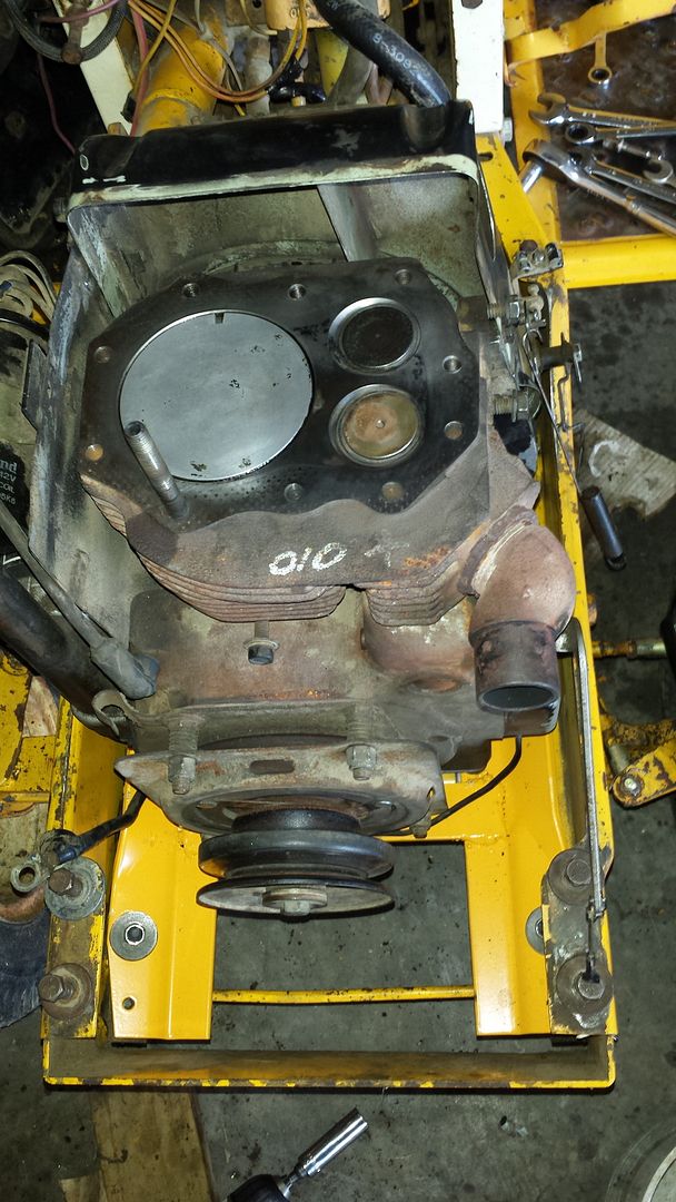

Old 07-30-2015, 07:11 PM
twoton twoton is offline
Join Date: Feb 2015
Location: MA
Posts: 2,540
So what's goin on timbo2, you getting that thing back together? Just wondering what your using for motor mounts.
  #28
Old 07-30-2015, 07:28 PM
timbo2's Avatar
timbo2 timbo2 is offline
Location: Kansas
Posts: 393
Yep getting it back together slowly but surely.
I'm using solid mounts from Jeff in PA.
Got the engine back in yesterday and have been cleaning up the piston and valves, adjusted the valve clearance.
Waiting on a new pto switch and need to clean up some wiring, flatten the cylinder head. Then clean the carb real good, this thing was set super rich when I got it a few weeks ago. the high speed needle was set out about 4 turns vs. 1.25 spec. lots of carbon to clean.
- Tim
  #29
Old 07-30-2015, 07:45 PM
Join Date: Feb 2015
Location: MA
Posts: 2,540
Looks like you got it cleaned up real good. Nice work. How 'bout the 3 pin driver, staying stock or going with a solid one?

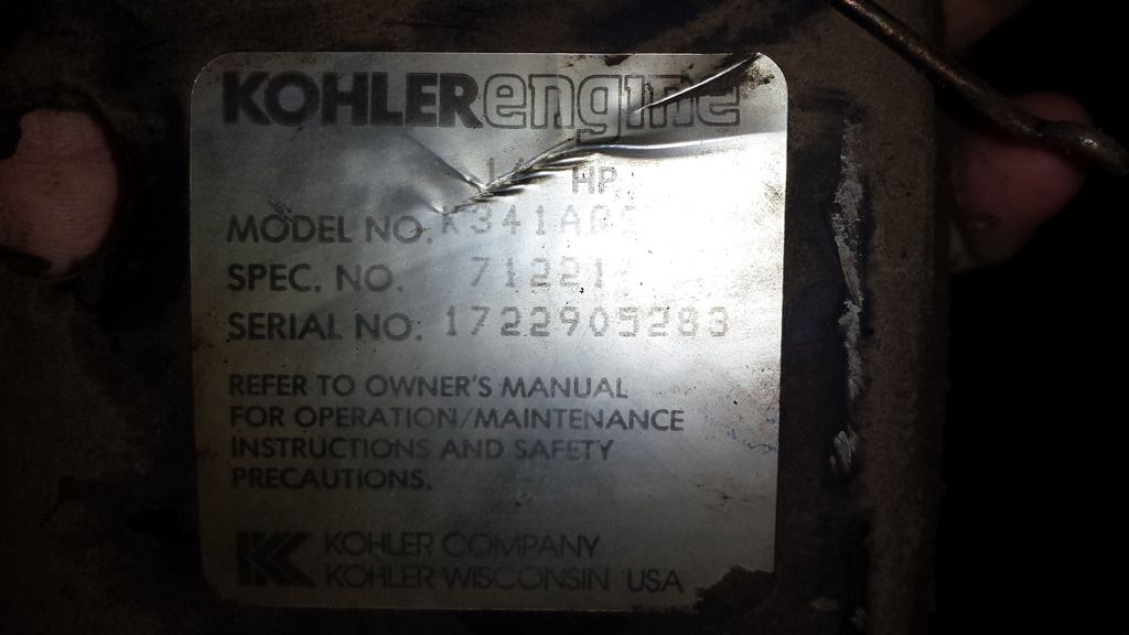

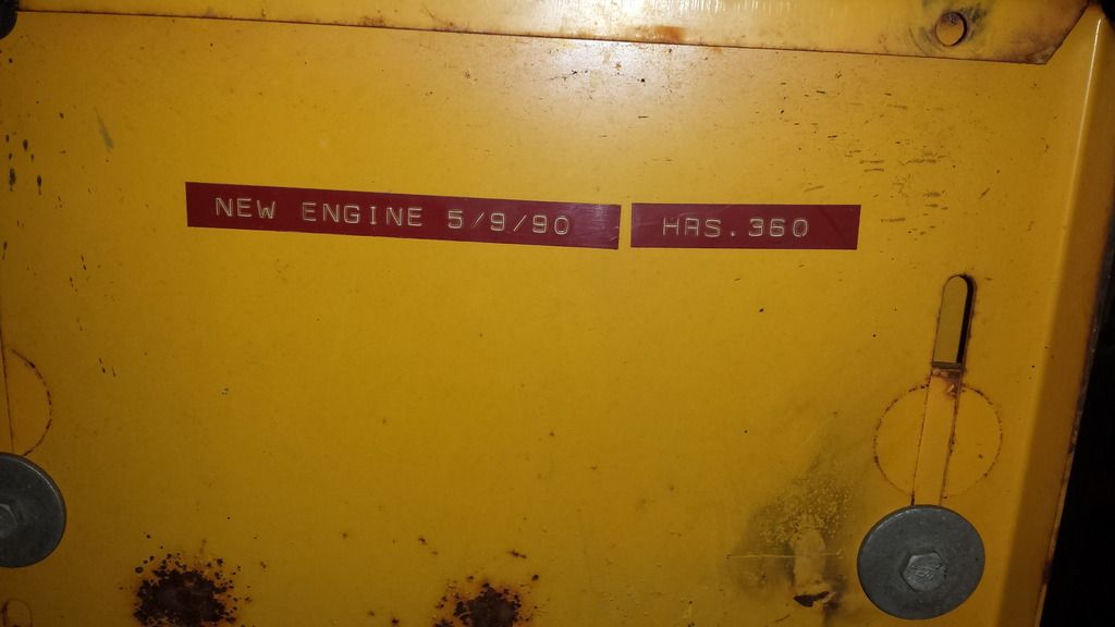

  #30
Old 07-30-2015, 07:55 PM
timbo2's Avatar
Location: Kansas
Posts: 393
It's a hydro 1650, technically a 1450 that got a k341 in 1990. Could be quite the machine before long.
