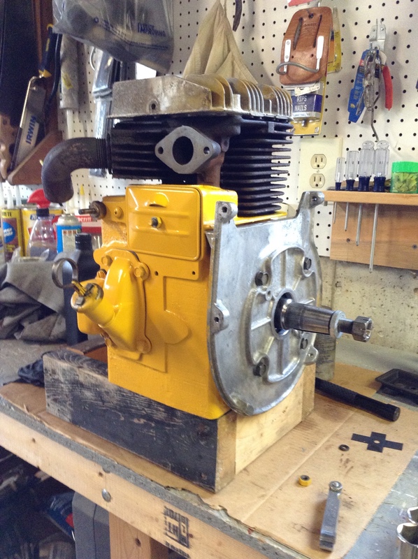

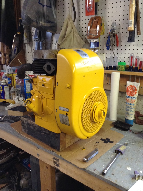

Time for an update!
Over the winter I built the engine. It really only took a few evenings so it was more like I built the engine and then stared at it for 4 months. :-)

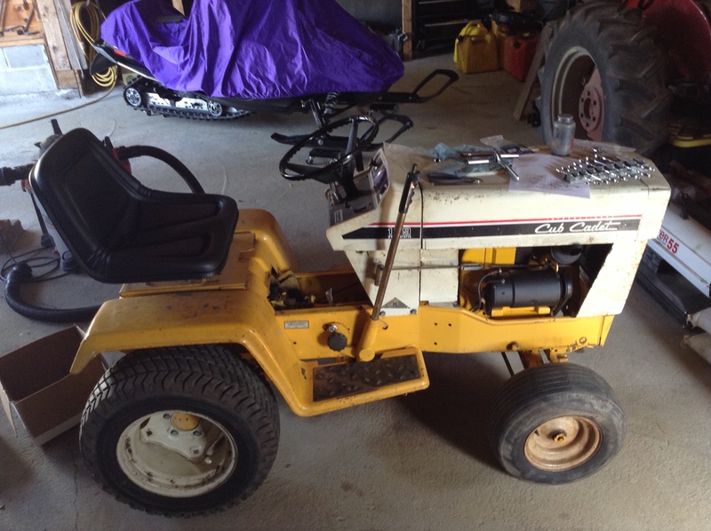

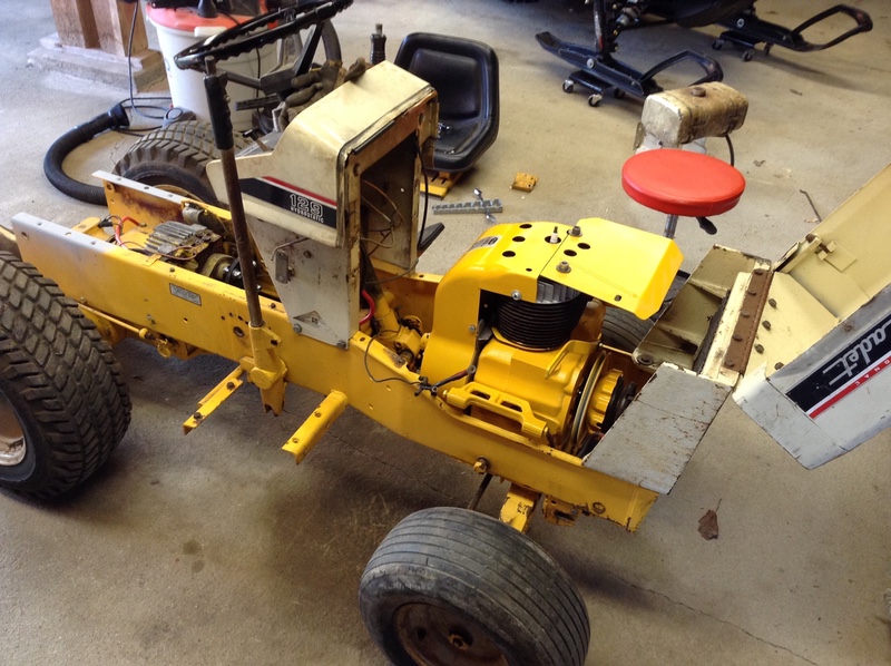

I dropped it in on Sunday:

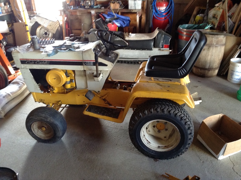

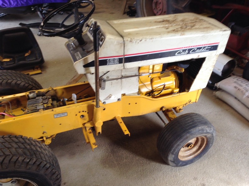

I spent last night bolting all the stuff back on:
Pretty much I need to drop the fenders back on, drop the battery in, add oil & gas and hope everything works!

Nice work on the 129! Going to be a good machine. Hard to beat that 12 horse. They are just about BULLET PROOF!
Good pictures!

Nice job taping off all the engine decals and paint looks good. I haven't seen the thread in a while, I like the trunion repair too, good work

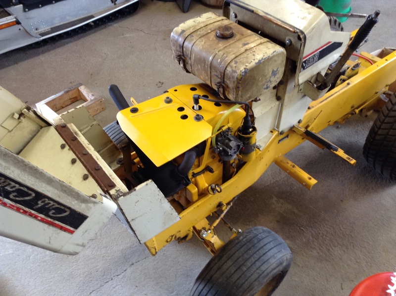

Congrats on a nice build
Glad everything turned out good. I was reading through the thread and on post 23# I see the breather reed laying on the table next to the engine, and thought, oh-no. But you must of replaced it......
All of the guts of the breather assembly are out in that picture. I just put the cover on while the bits were soaking in parts cleaner. It all made it back in before I dropped the engine in the tractor.
Good eye though!
