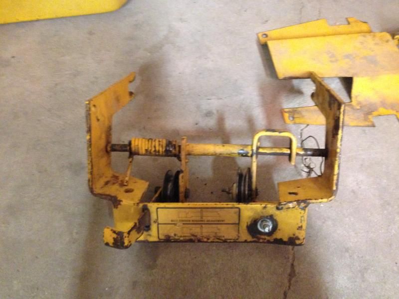

Well work is crazy busy right now, but i was able to get some work done sunday.
I have been halted by the steering wheel, and i was hopeing that some PB and a few stiff whacks would get it, but negative. so i will be building a puller pretty soon.

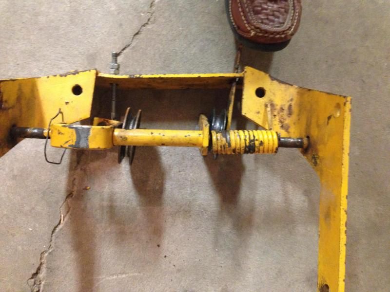

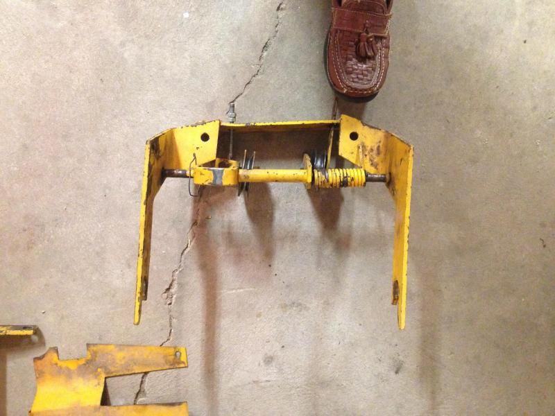

When i pulled the mule drive (i may be calling it the wrong thing) i noticed that someone apparently went full speed into a tree with it. Does anyone have a picture of how their pulleys look. i just dont know if the whole thing is crooked or just the frame.

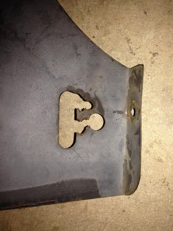

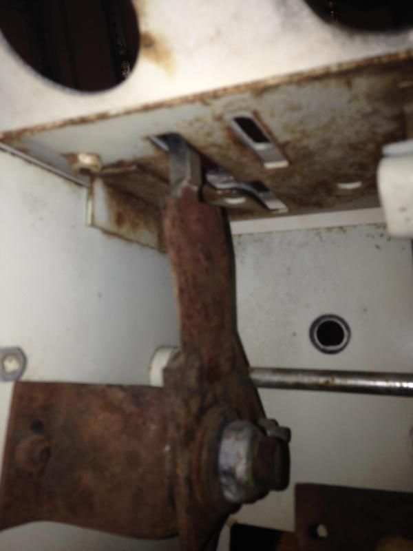

Also, has anyone has success fixing something like this, or is my best bet just to use self tappers in a different location.

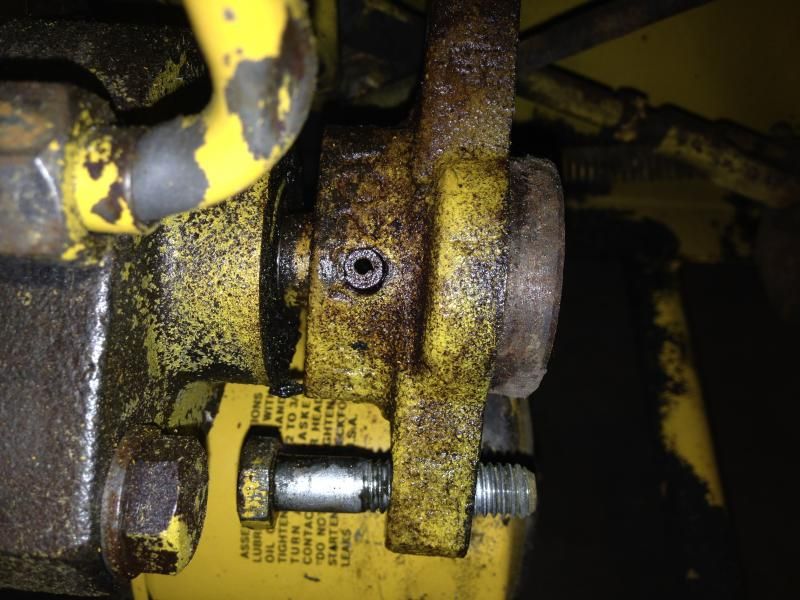

Should this part have any wobble to it. Its a little less than 1/8". im worried it is a result of being run for a long time with no iso or engine bolts.
and it looks like i will have to fab up a new bracket for the lever, this on has just given up

Your mule drive does look bent, but the pulleys are "tilted" on QL tractors to accommodate the off center drive pulley on the 44A and 50A mower decks. The mounting frame of the mule drive should be square, though.
The loose drive collar on the hydro unit is typical. Knock that pin out, check the hole in the input shaft. If it's badly wallowed out, you might have to repair it, but generally they don't get that bad, and you can probably run it as is. Put in a new spirol pin when you reassemble. Most of mine have a little play in them.

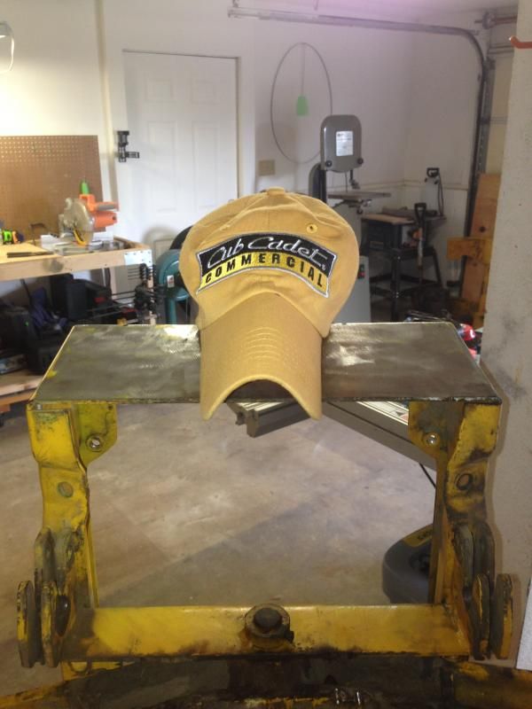

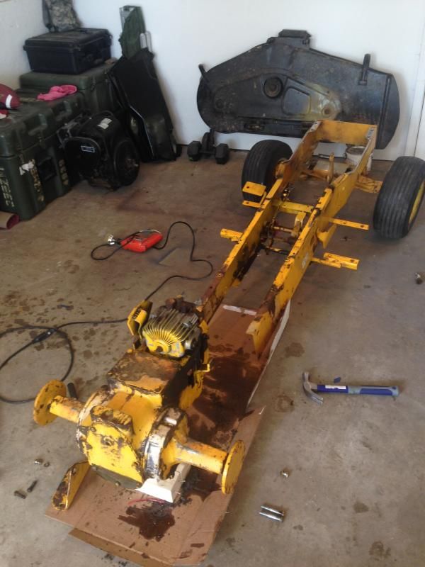

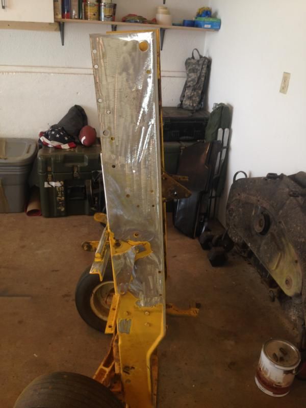

Well i got a little more work done today after finishing up the 4th of July festivities.
Finally got the steering wheel and column off, although it was at the cost of the wheel which took a stray blow by a hammer. So we will add that to the parts list.

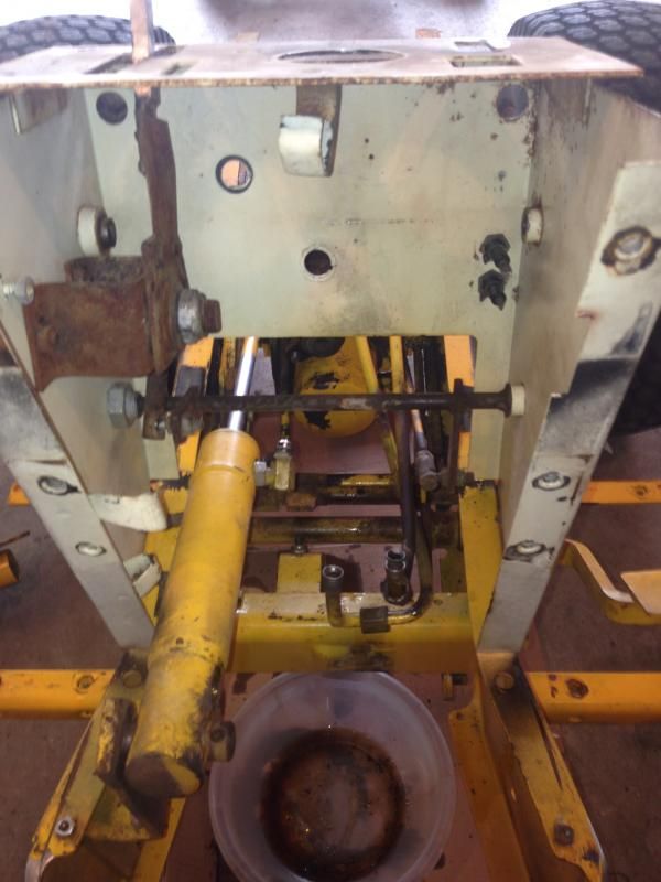

After that and some disconnecting of linkage, the tower was ready to come off.
Then with a few more minutes and left over beers in the cooler, BAM split tractor.
Then i got a little frisky and started to clean up the frame with a flap disk, but after about 20 min i decided that i am going to start calling around to see if i can get a good price on sandblasting everything but the sheet metal.
Much like when i got into running jeeps and the jeepforum community, i am learning that what all of you have said about these things nickel and diming you to death is true. But my wife has gotten on board and even got me this as well as an IH hat for an early B-day gift.
