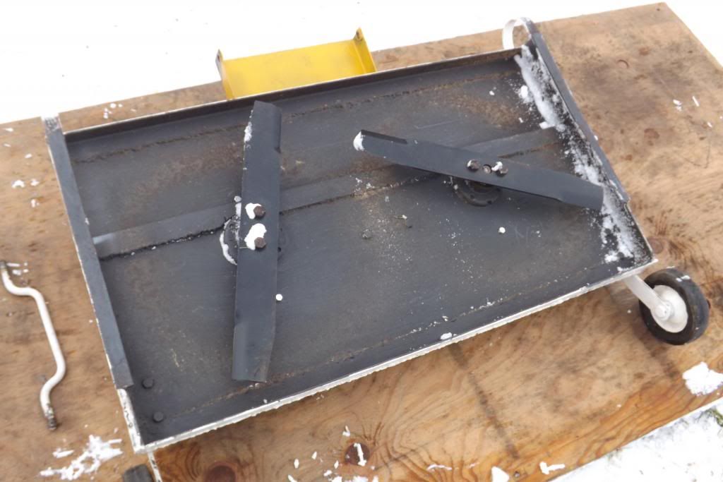

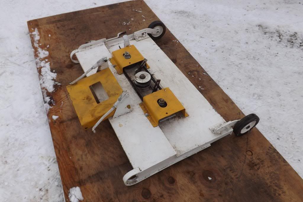

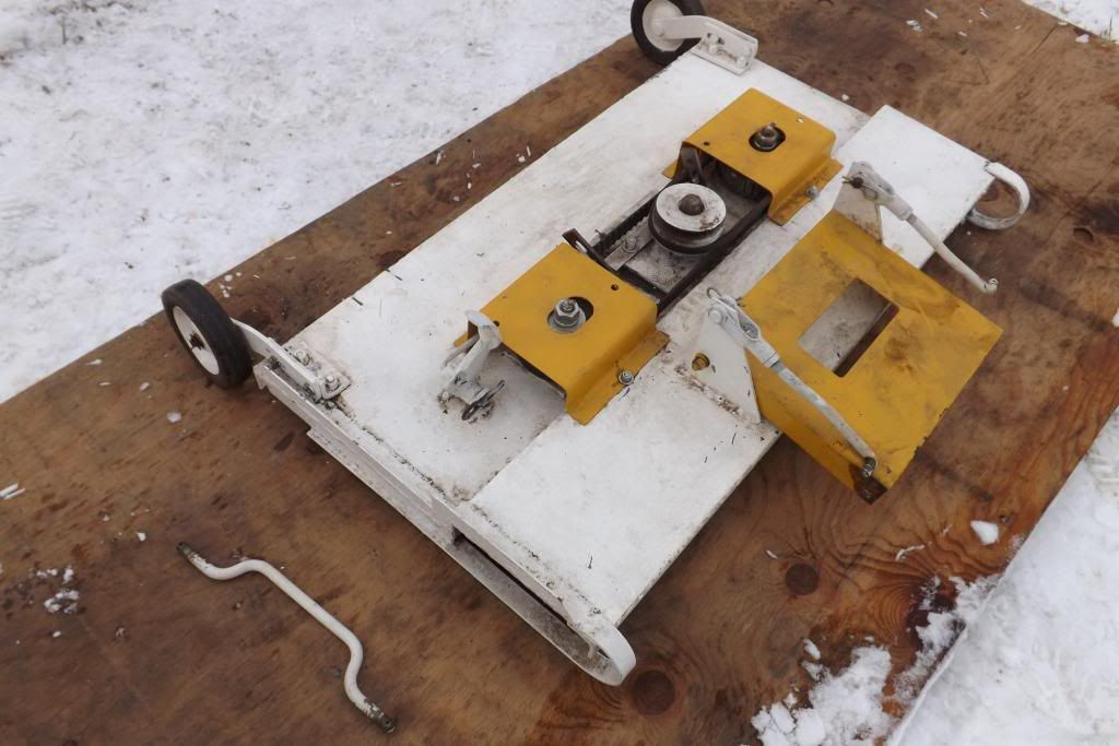

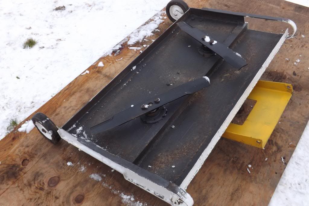

here is the deck the guy made. I'll be listing this for sale or trade soon with a video.

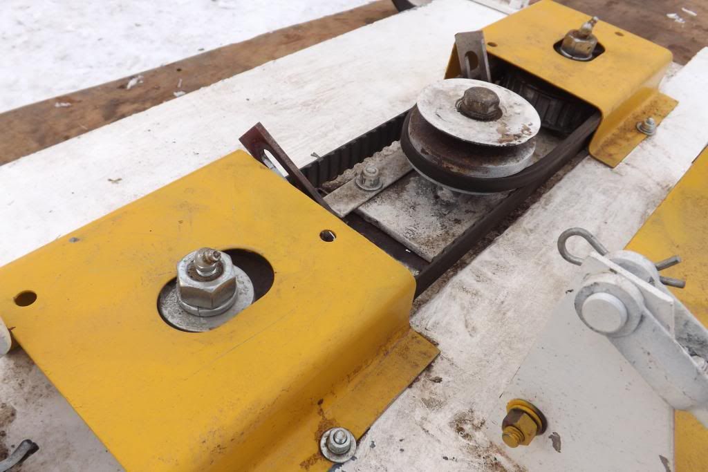

Here is a question; the deck intrigues me. I don't know that much about the decks for the originals, but I do know that you have the timed one (?) and that it is operated by the lever that is next to the pulley (that you moved in the video.) With the deck and belt installed, the center pulley spins when the engine is running. You push the lever down on the deck (w/ right foot?) and it engages the blades. How then do you stop the mower deck?

You pull up on the lever with the toe of your foot to disengage.
It's a primitive design relying on a slack belt to disengage. If the center pulley is spinning, so are the blades.

Like Bill said, lift the lever to shut off the blades. there is no clutch on the engine, just a pulley. so the long belt from the engine and pulley on the deck spins all the time.
