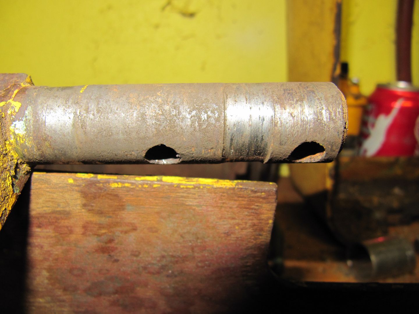

Haha, no not finished yet. I ordered the wire harness material and picked up wire to make me a new wiring harness today. I scraped down most of the frame. I took the brake pedal off and the shaft has slots worn into it, not sure what I can do there.... Anyways, Thanks!
Post a pic of the problem area, I have a couple ideas.
Here are some pics...

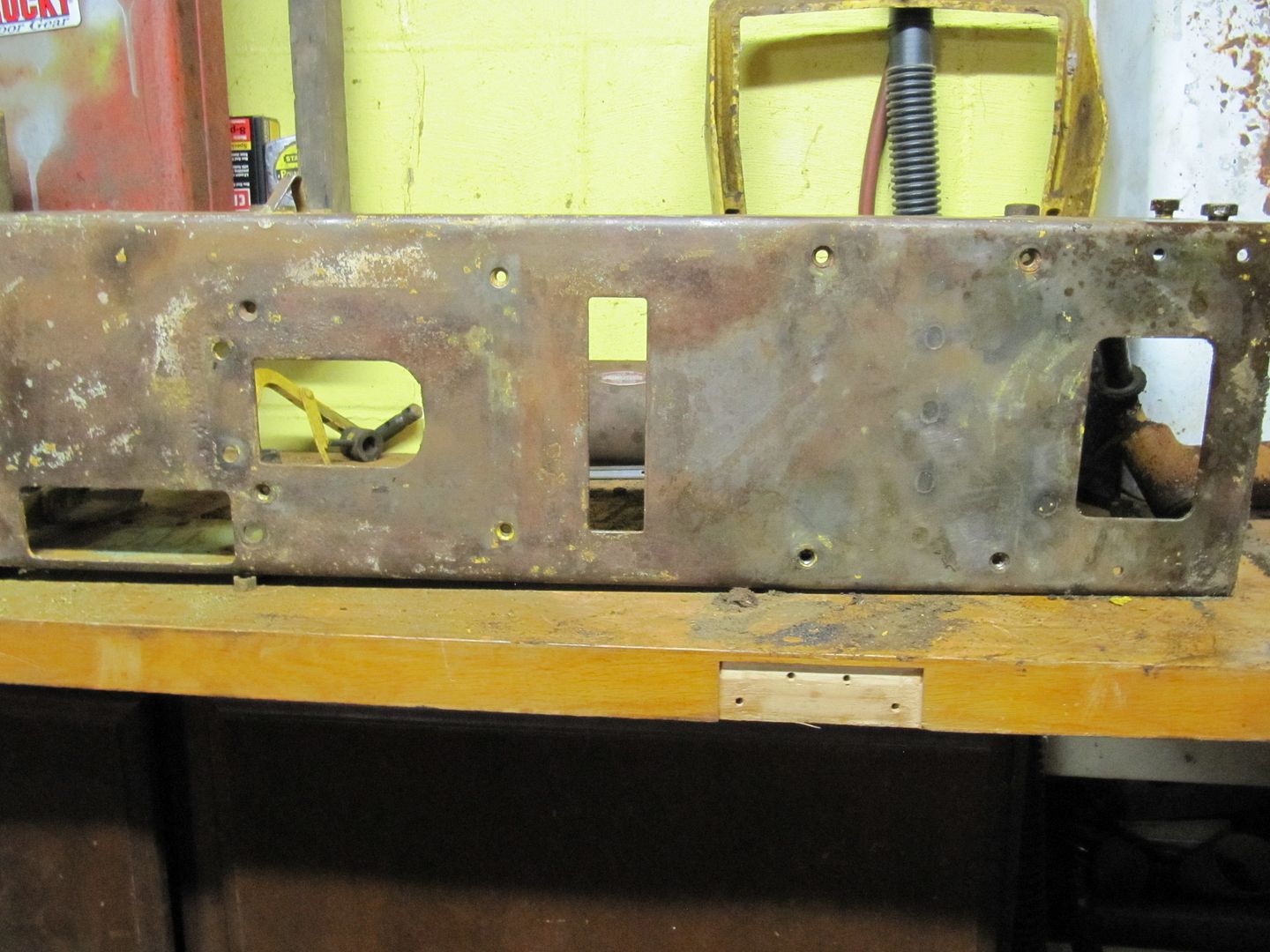

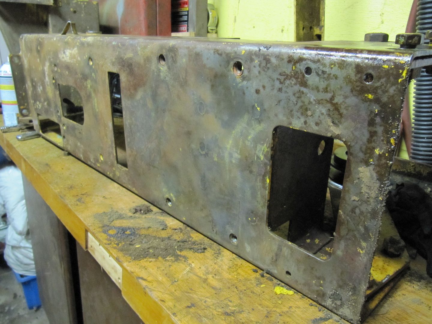

Here are some pictures of todays progress... I scraped down and wire wheeled the frame today.

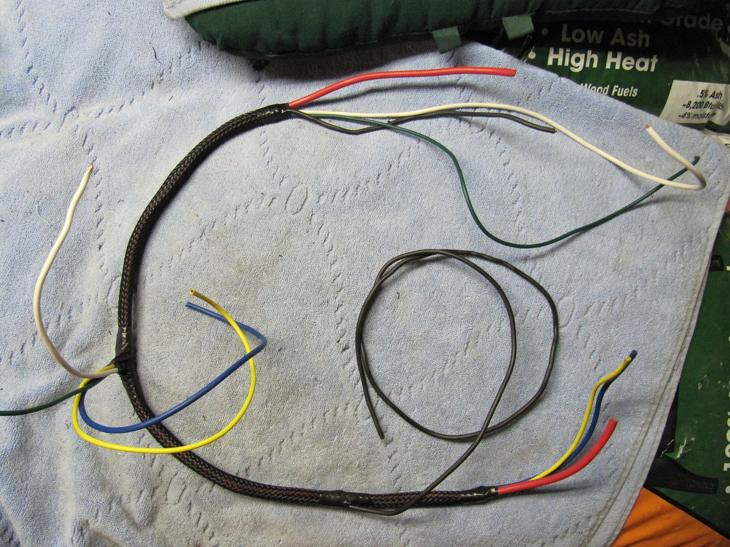

And Made a new wiring harness! It just needs new connectors

In another 50 years, that shaft could wear to the point of needing attention!

John, I totally agree with you, but I am trying to restore it to the best of my ability, the brake/clutch pedal has alot of slop in it when it is in place, just looking to minimize that.

You could always build up the shaft with a few beads of weld and belt sand it or draw file it down to size.

That is exactly what someone suggested to me! I will give it a try

Where did you get the braided nylon for your wiring harness?
