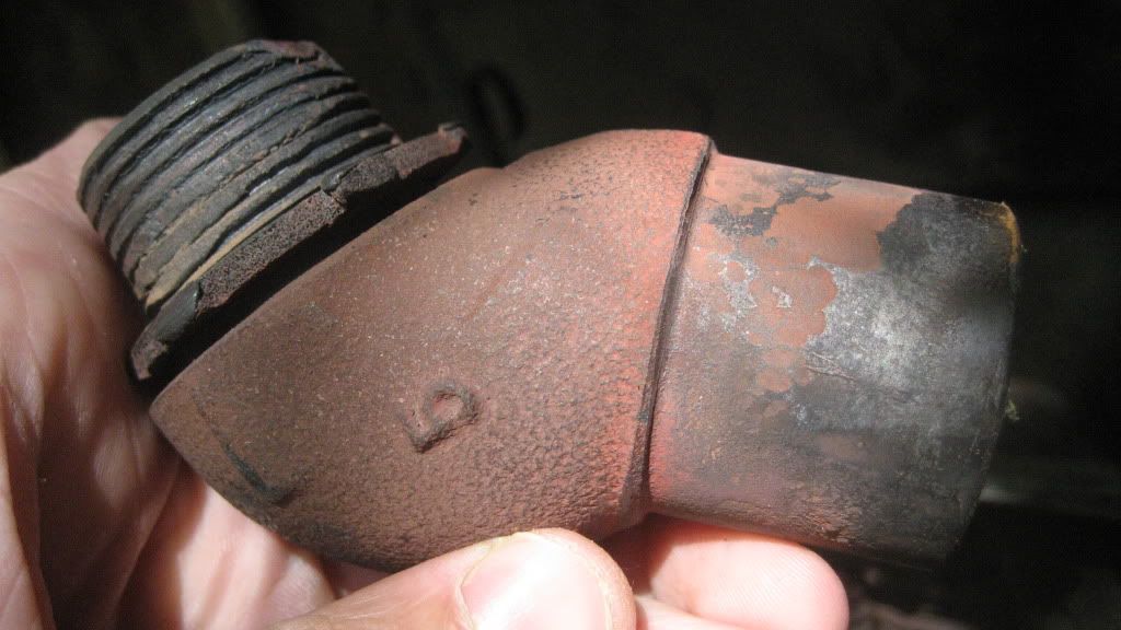

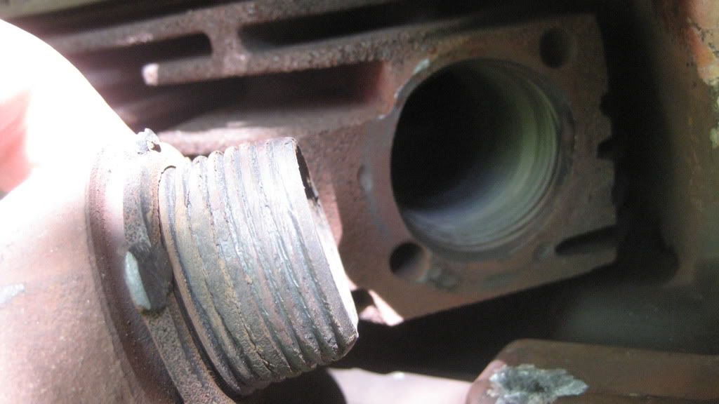

Here's the stripped and disconnected exhaust manifold:

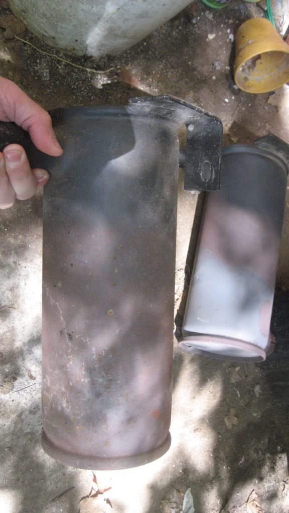

The two mufflers are identical, I just have no idea which one flows better or why grandpa had two of them:

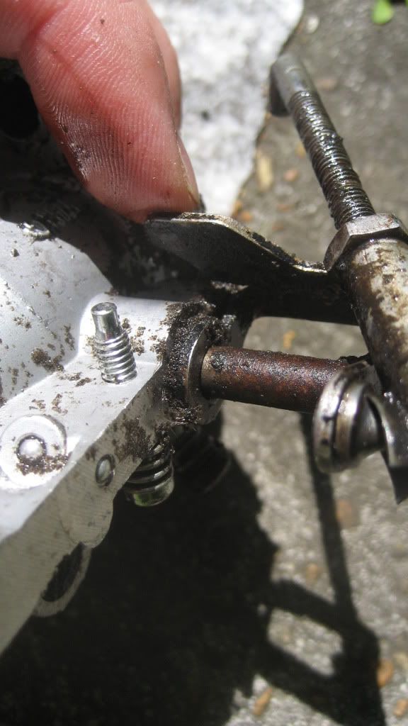

And here's the throttle shaft part I was talking about that jumps around while its running. If its just a worn out bushing, I'd love to fix it up on the cheap and keep on rockin with the sub-optimal Walbro:

Anyway, yes, that exhaust elbow sure seems like the threads are hosed on it. Hopefully the threads in the cylinder are still sharp and strong.
Looks like the Walbro has a bushing in it .....does the shaft wobble within the bushing or the bushing within the carb housing....or is it just the linkage shaking around?

Blow a shop vac into each muffler and pick the one that flows the most air!!

Good idea... just make sure the bracket is bolted down so you don't put more stress on the cylinder threads!

I'm seeing a similar looking exhaust manifold on ebay but its listed for a 10hp Kohler K241 and its used. Does this sound right? Anywhere carry this part new?
  #27
Old 04-12-2012, 12:30 PM
TheSaturnV's Avatar
Location: OK
Posts: 1,344
You'll have to confirm part numbers, but here's the one I bought for my 147 from Tulsa Engine Warehouse. Great prices.
http://tewarehouse.com/8284
  #28
Old 04-12-2012, 04:56 PM
The QL muffler is different from the other mufflers, so that generic one won't work. The elbow is also QL specific and probably isn't available new. If that elbow on ePay is from a 1000, it should work...the exhaust port on a K241 is the same size as the K321.
