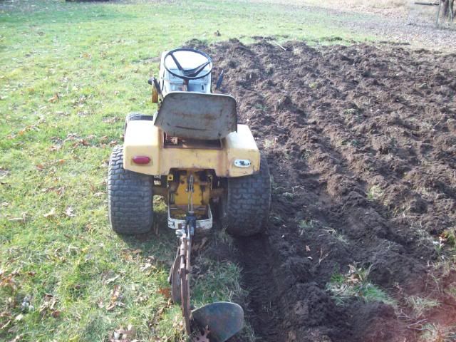

Do these help?

That helps! I want to plow some ground NOW! I havent turned over any soil with a mold board plow for 10-12 years! (farm tractors) Something about turning over the ground that is good for us.
I see the two 5/8 bolts that push against the plow attachment clevis use the heads to push with I had not picked up on that yet. Makes sense from a wear stand point. I also like the idea of a rod across the bottom pivot point. I just had short pins in each side, not as stable.
Your tractor and plow did a nice job turning over that piece of ground. So does a hydro have any advantages or dis advantages when plowing? Do you have the rears with liquid in them?

Cool, Glad to help!
Im brand new with plowing but its fun! With the single pin style plow I have I need an adapter thing that goes on the sleeve hitch before the plow is attached. The heads of the bolts have full contact on that piece. Near the bottom of my plow thread Merk posted a picture for me. He also helped me with adjusting it so it might be a good read for you. He talked about the 5/8 bolts and how mine needs adjusting to pull the plow more towards the right. Here is the thread. http://www.onlycubcadets.net/forum/s...t=plow+weights
I dont have any fluids but I do have 2 20lb Massey Ferguson 8" rim wheel weights and a log chain hidden in my under seat toolbox. Plus the 2 25lbs on the wheels. It works ok on softer soil but harder packed I did have a problem. I also noticed if you are trying to plow with high weeds the weeds plug it up and it just skims across the top.

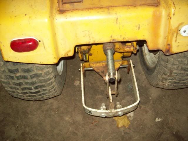

3. Some shots of the three point hitch (Brinley) I took Larrys advice / idea and made a solid 1/2 inch rod across the bottom pivot point. Then for the top link pin, I use the remaining piece of 1/2 inch bar and fabed a "T" handle.
Question do the slots in the lifting rods go at the top or the bottom? Or does it matter? I could not see on Larry pics and was to lazy to do the research. sorry.

Wow, your rear lift looks good!
Im not sure on the plow tip. On the lift straps I dont think it matters but I do think its suppose to be like you have them. If it was the other way then you might risk having them hit something being lower all the time? But even at the highest setting the lift straps being lowest(if it was other way) its probably still higher then the tip of the sleeve hitch. Im not sure but I think you are correct with the way you have it.
